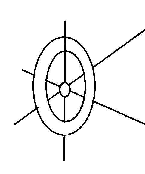

Ring of radius 10cm and charge of 3##\mu C## at the origin.
Ring axis aligned with z.
Electric potential along z is V=## \frac{kQ}{\sqrt{z^2+R^2}}##
Then another charge of -5##\mu C## and mass of 0.1kg released from the origin at u = 7m/s in k direction.
Find the velocity of q at z=3m

I actually kind of understood what you meant, but my workings doesn't reflect it. Here's my workings:
##W_{AB}=(V(z_A)-V(z_B))q##
##W_{AB}=3*10^{-6}(\frac{kQ}{\sqrt{R^2+3^2}}-\frac{kQ}{\sqrt{R^2}}) = 3*10^{-6}(\frac{(9*10^9)(-5*10^{-6})}{\sqrt{0.1^2+3^2}}-\frac{(9*10^9)(-5*10^{-6})}{\sqrt{0.1^2}}) = 1.30502...##
Since change in kinetic energy = Work done
##1.30502... = \frac{1}{2}mv_{f}^2-\frac{1}{2}mv_{i}^2 ##
##1.30502... = \frac{1}{2}(0.1)v_{f}^2-\frac{1}{2}(0.1)7^2 ##
##v_{f} = 8.666...##
which is incorrect. Any ideas?
There is a sign error in the work ##W_{AB}## and that's because you took as point A the point at z=3. Take as point A the point at z=0 and point B the point at z=3.
The formula for work is for movement from point A to point B.
Likes jisbon
I got it :) 4.79m/s.
