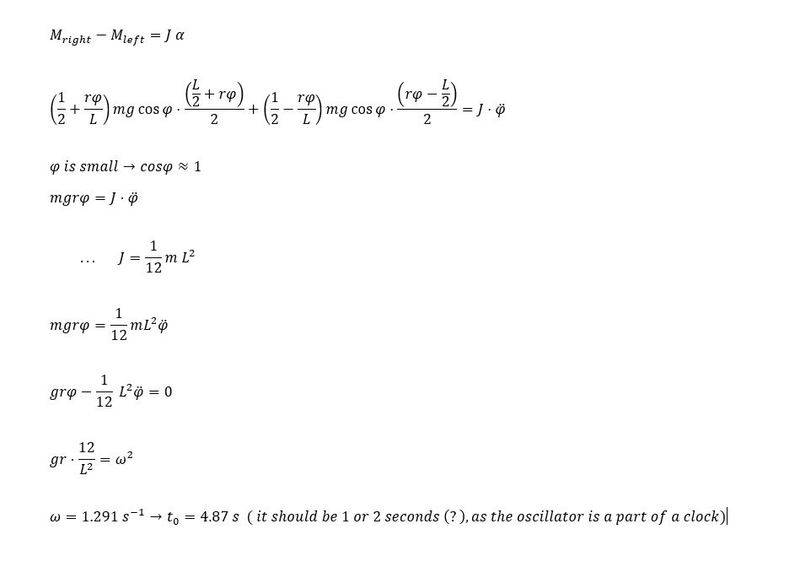

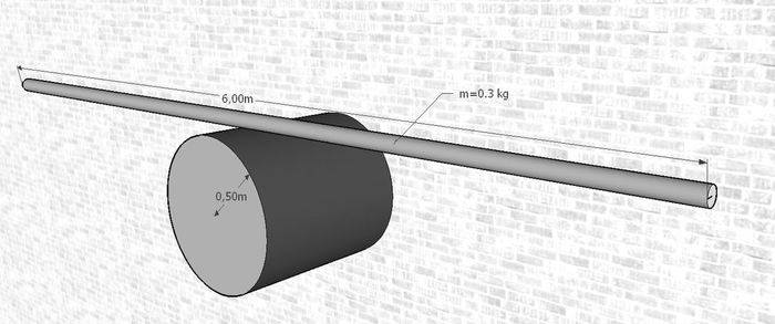

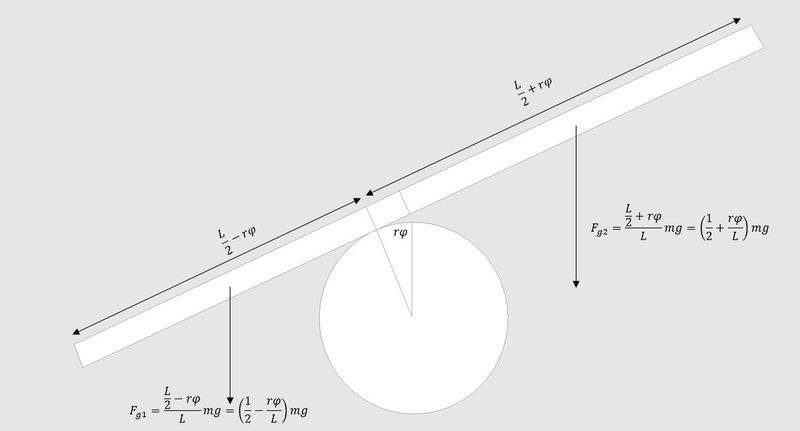

There is a cyllinder with radius 0.5 m fixed on the wall. We put a 6 metres long thin rod with mass 0.3 kg on it, which does not slip. I would like to calculate the oscillating time. It is a part of a clock, so the oscillating time is probably 1 or 2 seconds, but I got around 5 seconds. Please help me find a mistake.

Your work looks correct. As a check, I used a different approach and still got the same answer.
Likes berkeman and srecko97

Thanks for your reply ... I will wait for my schoolmates to solve it in order to compare our results. I am quite sure that everything is correct except the calculation of moment of inertia. Should I treat each part of the rod separately (the longest and the shortest part using a formula for a rod rotating around one end .. (mx^2)/3) and sum moments of inertia of both parts as it does not oscillate accurately around its centre of mass.
I still think that the answer is not correct, so everyone, please help me solve it.

You can show that the contribution of the center-of-mass motion to the inertia of the system is negligible for small oscillations. So, you are OK with just taking into account the rotational inertia about the center of mass, ##\frac{1}{12}ML^2##.

I did a rough experiment and the result for the period was reasonably in agreement with the formula you derived. I used a yard stick on a cylinder of approximate diameter 2.75''. Measured period was about 2.6 s. Compare to the formula prediction of 2.8 s.

Thanks for all your help! I really appreciate it! You inspired me to do the experiment. I put a thin tube (L=1.02 metres) on a ball (R=0.107 m). Formula prediction is tequation=1.82 s. I measured it tmeasured=1.92 s ... This is almost 5% accurate.
As older students write homework for us it is quite possible that the given data are not correct :D . Well, it is everything OK, but I do not know what sense would an oscillator with oscillating time 4,87 s have in relation to a clock. There is still an option that I have made a mistake... Correct me please, if so...

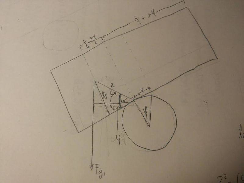

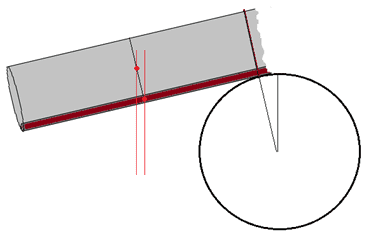

The next question is: What happens if we calculate the oscillating time considering that the rod is not thin, but it has width 2b (it is a cyllinder). So b=radius of this cylinder. I think nothing changes except the moment of inertia.
I am caluculating it in this way:
I found an equation for a rotating cyllinder around the perpendiculat axis (on the picture marked as xC or yC) in the middle of a cylinder.
J(moment of inertia) = 1/4 m*b^2 + 1/12 m*L^2
In our case the cylinder is not rotating around the axis in the middle of it, but around the axis which is a tangent on surface of this cylinder, so I think that the desired moment of inertia for our case considering Steiner's rule is:
J = m*b^2 + 1/4 m*b^2 + 1/12 m*L^2
Is my thinking correct?
Are the moment arms of the forces affected by b?
OK (for small φ)
Likes srecko97

Yep I forgot to consider that. The moment arms gets longer considering Pitagora's Theorem. arm^2= former arm^2 + b^2, right?
Does this give the correct moment arm for each side when φ = 0? Does the moment arm on the left side and the moment arm on the right side both get longer due to b?
No, that's not a good guess. Draw a diagram.
I think it gets very very very very complicated if I consider the change of length of the momentum arm
I do not have any data about b, so I cannot caluclate numbers for alpha or R, so it would get more difficult if I wanted to calculate the omega without numbers.
You are interested in how much the moment arm changes as you add the effect of b. Your R does not represent the change in the moment arm. Think about where the force on the left side acts before taking into account b and then after taking into account b.
The force acts in the center of mass of the left part
Honestly I do not understand clearly what you want to tell me. Can you help me please with some equations or sketches?
On the left the moment arm gets longer, but on the right it gets shorter

Some labels for points:
A = Bottom left corner of the rod
A' = Top left corner
B = Point of contact.
B' = Point on top edge nearest B (so AB=A'B')
C = Mass centre of left hand portion (i.e. from AA' to BB')
D = Point on AB nearest to C
You already know the horizontal distance from B to D. You now want the horizontal distance from D to C to add to that. Can you see how to get that?
Likes srecko97

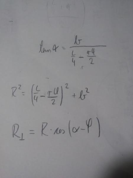

the new moment arm is for b*tanφ longer?
Apparently, this came from a triangle. Can you describe the triangle?

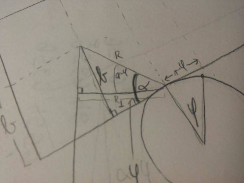

OK, We are probably using the term "moment arm" differently. I think of it as the perpendicular distance from the axis of rotation to the line of action of the force. You might be thinking of it as just the distance from the axis to the point of application of the force or something else?
Ok, I know my previous attempt was wrong. You could think that I am just guessing the right equation, but no! Now I think that my answer is correct. The moment arm gets longer for b*sinφ, ok?
Yes, good.
On the other side it gets shorter for b*sinφ
  • #31
Yes.

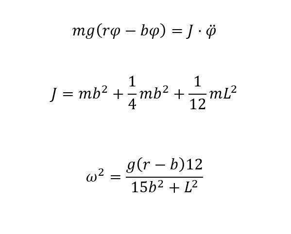

But when talking about small φ that has no sense
  • #33
Why is that?
  • #34
sin φ ≈ 0 for small φ
  • #35
That's going too far in the approximation.
