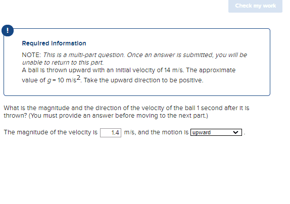

i am 100% just lost.. i understand (somewhat) what it is asking but i cant seem to know which equatin to use to solve this problem?
Question asked: A ball is thrown upward with an initial velocity of 14 m/s. The approximate value of g = 10 m/s2. Take the upward direction to be positive. What is the magnitude and the direction of the velocity of the ball 1 second after it is thrown?
no sure which one to even use
i have tried V=Vi - (g*t) with an answer equals to 4
as well as
d=Vi(t) + 1/2 a t^2 with an answer equals to 19
my final asnwer was 1.43 and it was still wrong
i used formula a=v/t
v=14
t=10
i divided 14/10 to get 1.4
Looks good, but you should always specify units. If this was flagged as wrong it suggests you have not entered the answer in the form expected.
It asks for "magnitude and direction", but tells you to take up as positive, which means simply answering "4m/s" should be fine. Hard to say more without seeing a screenshot of the question page and exactly what you entered.

Please show your work that led you to the answer of 1.4 m/s that you entered.
v=14
t=10
v=14
t=10
I post #1 the formula you quoted was V=Vi - (g*t)
Likes lesdayy
You are not looking for a, the acceleration, which is given as 10 m/s2. You are looking for the velocity at the end of the 1-second interval when the velocity at the beginning of the interval is 14 m/s.
Likes lesdayy

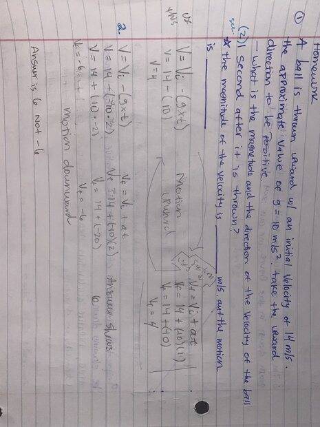

so when using g = 10 m/s2 the 10 would always be negative ? or depends on the direction its going ?
the second part of that question is t=2
my answer ended up being negative but the correct answer is positive
'g' is defined as the magnitude of the acceleration at Earth's surface, so it is always positive.
Whether g or -g is used in the equation depends what has been chosen as the positive direction. Normally one chooses the same direction as positive for all displacements, velocities, accelerations and forces. For vertical motion (on Earth's surface) up is generally chosen as positive, making the equation ##v_f=v_i-gt##.
It asks for magnitude and direction, filled in separately. A magnitude is never negative. For a scalar, magnitude is just the absolute value. So the form of the answer is 6m/s, downwards.
Likes lesdayy
