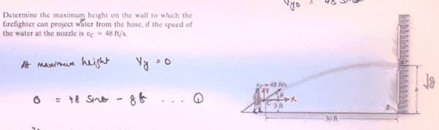

Find the maximum height on the wall to which the firefighter can project water from his hose. The speed of the water from the hose is 65 ft/s. The height at which the hose is held is 3 feet.

Using the equations for constant acceleration, we can write the following set of equations for this problem:
We have the following known physical constraints:
Solving the above system of equations and constraints with a computer algebra system:
So, all the solutions I found make physical sense. It's not as any of the solutions are saying that the firefighter is holding the hose backwards with respect to the wall or something.
My teacher said the answer is:
And my teacher made no note of the other solution set.
Why is it that this problem, even when set up with the proper equations and reasonable physical constraints, yields two unique solution sets?

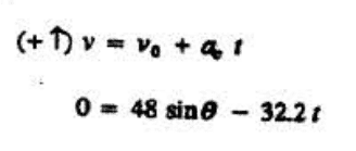

Why are you assuming that the vertical component of the water's velocity will be zero when it hits the wall?

That's a great question, and from my discussions and research, I was told that this assumption is incorrect in this problem.
That being said, the book's solution manual makes that assumption, and so does my Dynamics professor:
But it seems that even if we take this assumption as valid (which it is not), the book chooses the lower of the two heights that one finds after solving the system of equations I presented.
Why is it that the book takes the lower of the two heights?
What should the takeaway be here? What is the pedagogial value of this problem?

I agree that that assumption is incorrect. Making that (incorrect) assumption turns the problem into solving for the angle of the hose so that when the water hits the wall it is at the maximum height of its trajectory.
Given that assumption, there are two solutions. Picking either is arbitrary. But if you wanted to imagine you are finding the maximum height (which you are not, given the mistaken assumption), why not pick the second solution?

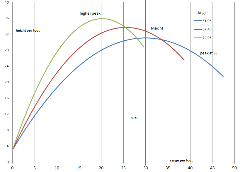

Using the erroneous assumption that it coincides with the peak of the arc, I get the greater of the two solutions as 27.63 ft, rather less than your 30.63ft, but with the same 61.5 degree angle. That would be the solution to choose, not the lower one.
Using your correct approach I get 29.5ft, so only a little more. Angle 67.3 degrees.
In fact, keeping it entirely algebraic, the correct solution in general only beats the higher top-of-arc solution in a fourth order term.
Correct: ##\frac{v^2}{2g}-\frac{gx^2}{2v^2}##
Higher top-of-arc: ##\frac{v^2}{4g}(1+\sqrt{1-\frac{4g^2x^2}{v^2}})##

I don't suppose it will be of much interest to the math whizzes, but just for my own peace of mind, I plotted a few graphs.
FWIW? Here are a set of three which show me what's going on. (As usual when the algebra got messy, sorry, I just did an iterative numerical approximation.)
I did angles much closer to the optimum, but spread them out to show the peak at 30 jet.
