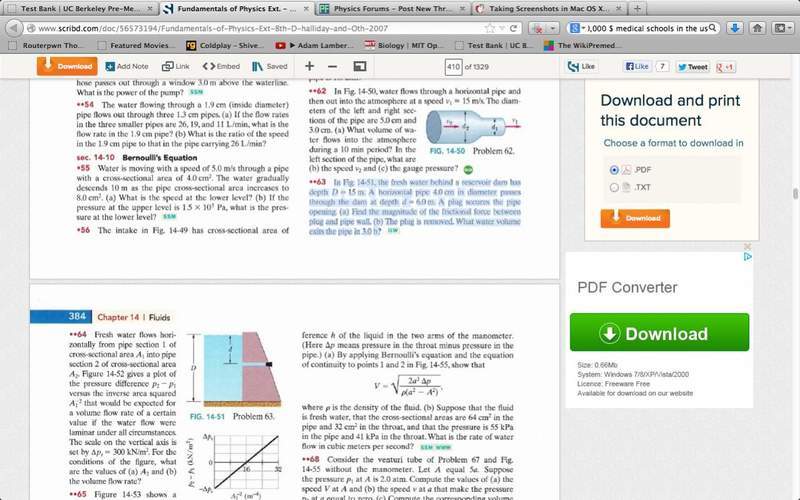

Hi please check the highlighted question in the attachment and the solution and see the problem, i need help please. I have two questions about it:
1- why didn't we take the plug as a vertical wall and thus the force would be integral of pressure x area?
2-WHERE DID THE FORCE DUE TO ATMOSPHERIC PRESSURE GO?
Thnx for your help.

Hi Bassel! Welcome to PF! :smile:
You did.
You did ∫ ρgA(H+h) dh, but the plug is so small that you can take H+h to be a constant, H …
so that integral is just ∫ ρgAH dh :wink:
it nipped round the other side when you weren't looking, and started pushing back :smile:
(so it's the same on both sides, and you can ignore it)
by the other side you mean from outside ??
yes, the plug has two sides :smile:
