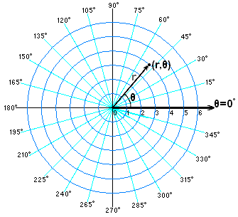

do you know what polar coordinates (r,θ) are?
EDIT: these are (r,θ) polar coordinates:
they are two-dimensional, and they cover the (x,y) plane in the above grid instead of the usual (x,y) grid squares
cylindrical coordinates are (r,θ,z) instead of (x,y,z) … the z in both is the same … the (r,θ) is the same as in polar coordinates … they are three-dimensional, and they cover the whole of (x,y,z) space

I know theta but what does the "r" stand for ? Theta radian ? And how do they replace the x and y co-ordinates ?
"r" stands for "radius", it's the radius or radial coordinate, equal to the distance from the origin
so those circles are all "lines" of constant r (0 ≤ r < ∞)
my diagram shows polar graph paper (see eg http://incompetech.com/graphpaper/polar/), which covers the whole plane in a grid like the usual x,y grid …
you specify the position of a point by the grid-lines it lies on (or would lie on if they were there): the line of constant θ, and the circle of constant r :wink:

so the "r" is the lines of co-ordinates and theta is the angle between the line (which represents distance from object to origin) and the radius representing the y co-rdinate ?
i'm not sure i understand that
the straight lines are lines of constant θ and increasing r
the circles are lines of constant r and increasing θ
there is no direct relationship between the r and θ coordinates and the x and y coordinates
And if it is so (that the radius here is the X,y and z ) if there's a radius representing that ,does that mean that thi isn't a circle and that we're dealing with a sphere ?
no, polar coordinates, as i said, are two dimensional, they cover a plane
if you add a z coordinate (exactly the same as the usual z coordinate), you get cylindrical coordinates, which of course are three-dimensional
