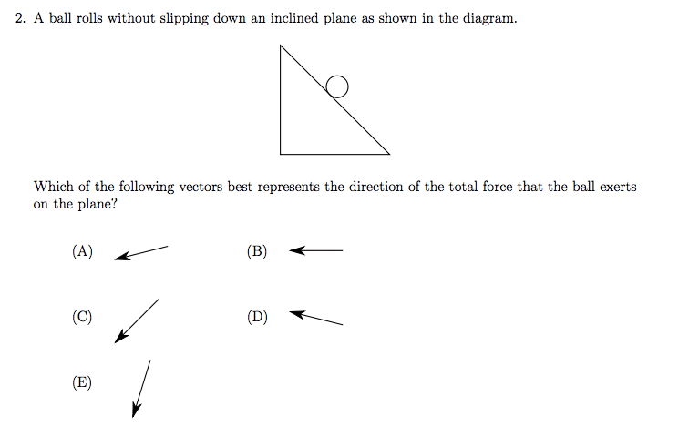

Could someone please provide a diagram of all the forces acting on the plane, and explain why the answer is E?
This is from the 2014 F=MA exam.
What are your thoughts on this ?
Draw a free body diagram listing all the forces on the ball ? Think carefully about the condition that the ball rolls without slipping on the inclined plane .

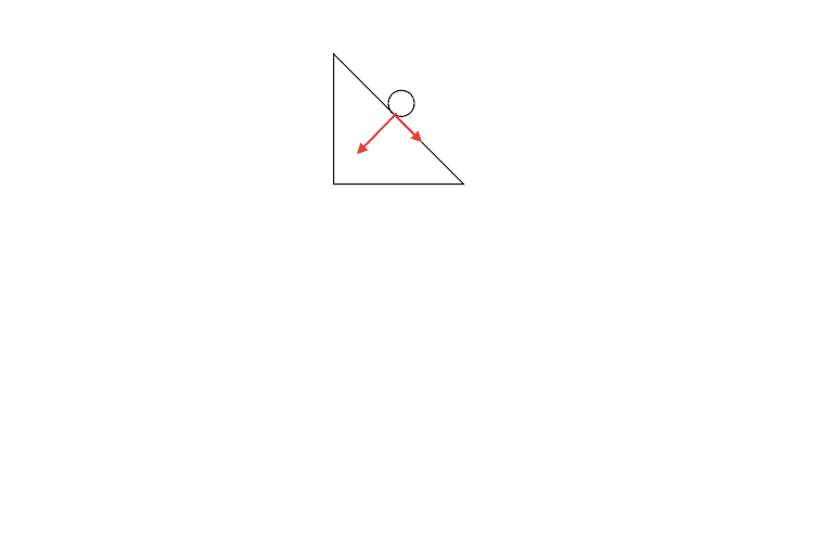

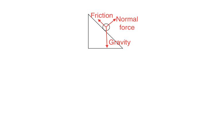

This is what I have so far:

Now this is how my teacher explained it:
Every force has an equal and opposite reaction, so the friction force acting on the ball has a force that acts the other way.
The normal force that pushes the ball up also has a force that pushes the plane down, so:
But where did gravity go?

This is not how you think . Weight is not the force by which the ball pushes on the plane .Weight is the force of gravity exerted by Earth .
It is the Normal force from the ball which pushes the inclined plane in a direction perpendicular to the plane .And it is the frictional force from the ball which exerts a force along the inclined plane surface .
Likes blueblast
But presence of normal and frictional forces in the given problem is due to gravitational force exerted by Earth . If force of gravity is somehow absent , then zero normal force , zero frictional force . Ball stays in the place where it is put without exerting any force on the inclined plane :smile:

The hard part in this question is choosing between A, C and E. The direction of the vector in C appears to be normal to the slope. You need to assume that is intentional.
