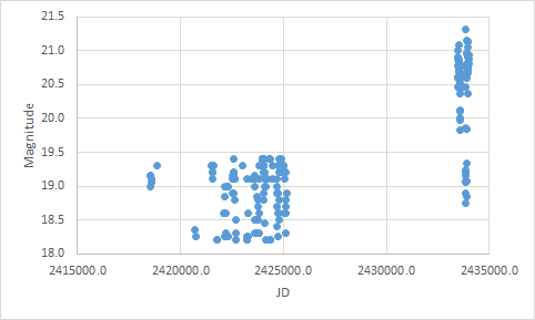

I think you're right about my misunderstanding. From the science paper I've read by AAVSO, they " performed a Fourier analysis on the resulting combined light curve to obtain the period, ..." , so I assumed Fourier analysis in this case was Fourier series, since I've learned that cepheid variables should undergo pulsations with a regular period, and Fourier series was for functions with the same periodicity. I should redirect my focus and try to learn more about Fourier transform now.
I was trying to plot the AAVSO data on Excel, with the y-axis being the magnitude, and the x-axis being the Julian Date. But I wasn't able to obtain any sort of light-curve-like graph. Could I be misreading the data from the database?

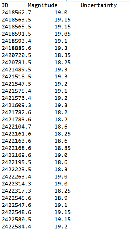

A section of the data from AAVSO:
Thank you so much again for your help!

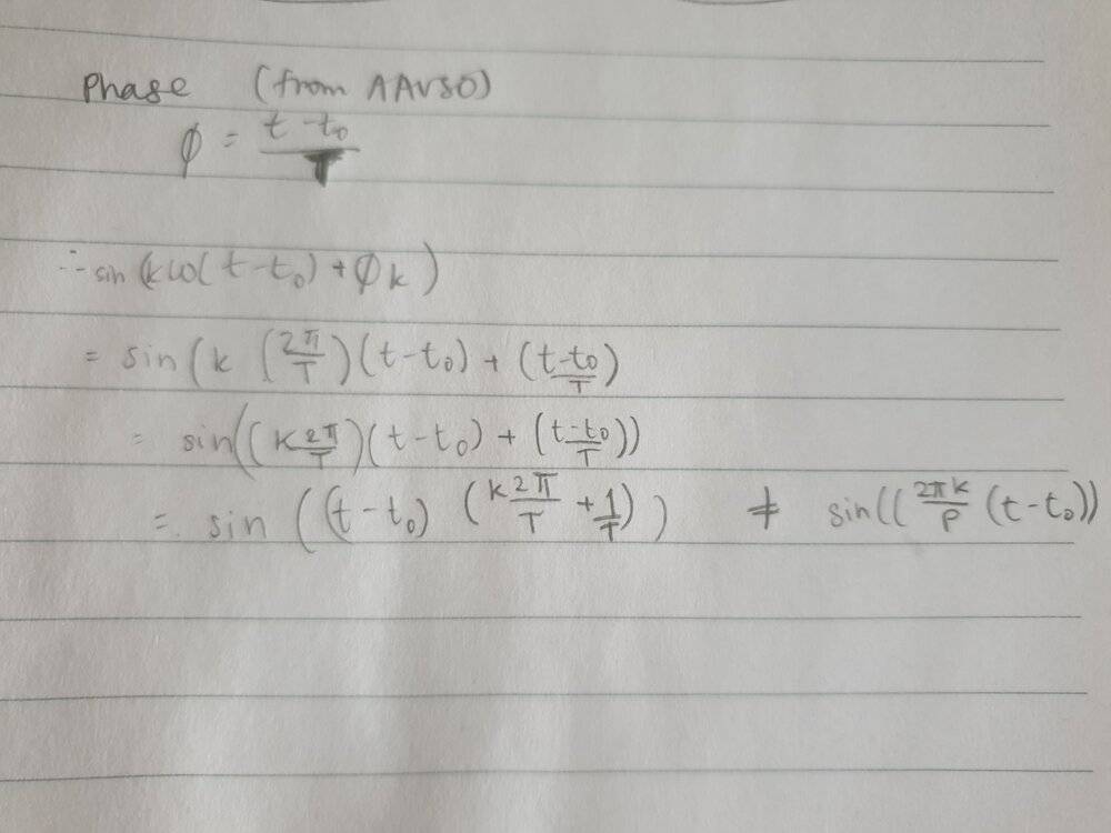

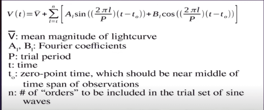

Hello. Thank you very much for your help! After asking my math teacher, I was able to use code to find the period of the M31_V1 from AAVSO data.
I'm a little stuck on the Fourier series aspect in order to obtain the light curve of the graph though.
From this equation, how do I know what the zero-point time is?
Does middle time span of observations refer to the averaged time from the AAVSO data?
I.e. finding the mean of the Julian Dates from the 206 raw AAVSO data points (?)
Also, how do I determine the number of orders? Do I do so experimentally by trial and error?
Which time should I take?
Thank you so much for your help!

@no_drama_llama_77 the zero point in time to choose doesn’t matter. You just get a different phase value out of the transform.

It would be a lot more helpful to give us a table of the numbers and not a picture of a table of the numbers.
I got this from the AAVSO database

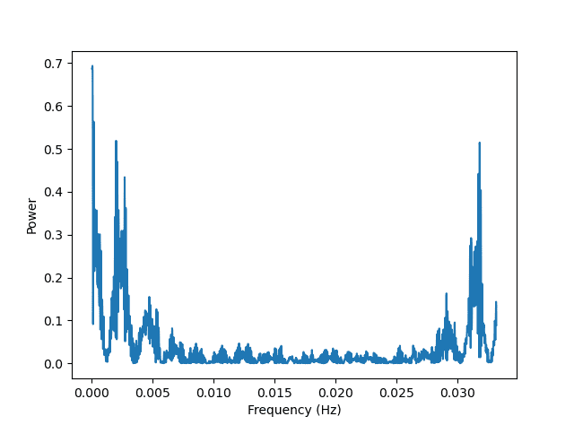

Actually, I found a code to find the period (using Lomb Scargle Periodogram), however, I'm struggling with how to mathematically work out the Fourier Series for the light curve based on the two frequency peaks I found from my power- frequency graph, assuming the peak at 0 frequency is an error/noise(?). (I've attached my spectral density graph obtained from the coding)
Since this is for my math IA for the IB (international baccalaureate), I need to show some mathematical calculations.
Thank you for your help.

I looked at the Excel data, du0plicated your chart, and am wondering if the data has problems.
First oddity: the pre-1927 data looks different than the post-1950 data.
Second oddity: the gap between 1927 and 1950
Third oddity: 2423610.6 has two values, not very close to each other
If I take the data seriously, the change in magnitude per day is around 0.2 or 0.3. I'm looking at a swing of maybe 1.2, so I am looking at a period of maybe 4 days. But many of your samples are a month apart.

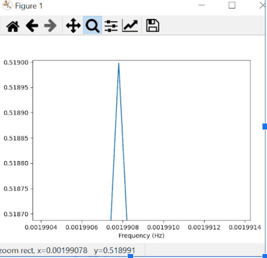

I ran a Lomb Scargle Periodogram analysis on the raw data instead of a normal Fourier Transform for the same reasons you've mentioned: the data is quite unevenly spaced. As for the 1st and 3rd oddity, I didn't think much about it as I'm very new to processing this kind of data, but as a pointer given by @phyzguy , I made sure to only process the data that was collected with the same filter band (in this case B). So I'm assuming the uncertainty should be roughly the same as the same filter band was being used?
That is almost certainly just noise.
Your minimum time between samples is 0.1 days. (I suspect that it's even worse and it's just rounded to 0.1 days, but let's assume it's 0.1 days). Thats' 8640 seconds, so the highest frequency you can possibly see is 0.00012 Hz. That's all contained in your first "peak". All the peaks to the right are pure noise and artifacts.

I ran a Lomb Scargle Periodogram analysis on the raw data, for the same reasons you've mentioned: the data is quite unevenly spaced. As for the 1st and 3rd oddity, I didn't think much about it as I'm not a
Actually, I'm assuming the period is one out of the two second-highest peaks, one on the left and the other on the right.
From my calculations
Period for the left frequency: 502.3156753… days
Period for the right frequency: 31.38948703… days
A paper has made observations on the period of M31_V1, and they obtained a period of 31.4 days. Therefore, I think the peak on the right is not noise but rather the closest to the correct period, while the frequency peaks on the left are noise or an alias period?
https://arxiv.org/pdf/1111.0262.pdf
A. Please watch the precision. You are not getting 11 digits here no matter what you do: that's 10 ms over the entire observing period.
B. Please wtach your units: the tick marks go from 0.005 Hz to 0.030 Hz. That's a period from 30 to 200 seconds. You can't see a 30 day period on this plot, nor distinguish it from 500 days.
If you sample every 2.4 hours, you can't see a 200 second effect. It's got to be noise.
  • #33
A. I wasn't sure what the data uncertainty was, so I rounded my figures to 3 significant figures in my written report. Will that be appropriate?
B. When I apply the Lomb Scargle Periodogram to the data, does that mean my frequency is actually represented by the units (1/days) rather than the usual (1/seconds), since the AAVSO data measures the period using Julian dates (days)? I may have mislabelled my spectral density graph.
I obtained 502 frequency by dividing 1/0.00199078. I obtained 0.00199078 by estimating the coordinates of the second-highest peak on the left
  • #34
Do you think so? That means you think you know the period to one part in a thousand. (And for that matter, that the period is stable to one part in a thousand)
If days are the input than 1/days is the output.
That said, I am still far from convinced that you are doing anything besides chasing fluctuations.
A. If you split the data into pre-1940 and post-1940 do you get the same answer?
B. If you fit even and odd data points do you get the same answer?
