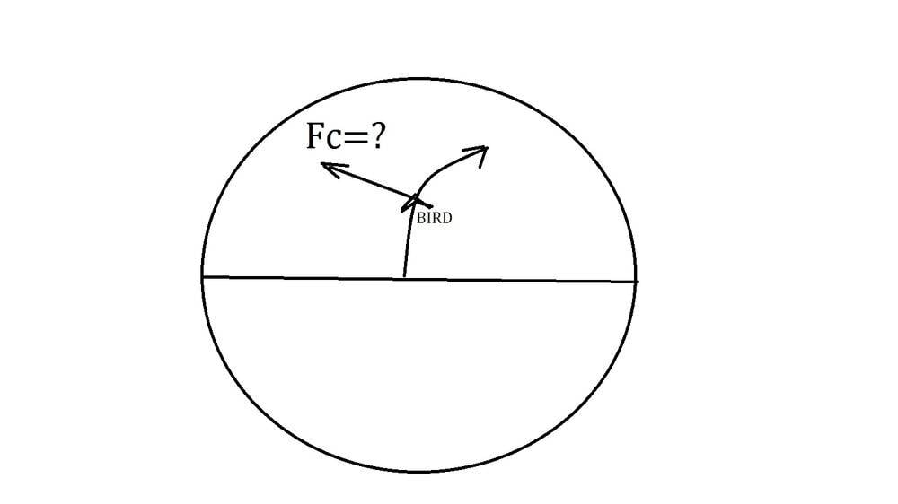

Do you agree with below explantion?
" Why wind in the East direction at non equator latitude is deflected South, is a bit trickier, and involves the use of centripetal force. this is given by the equation:
F=mv2/r
If we re-arrange the above equation, we can find r in terms of v, and we arrive at:
r=mv2/F
This tells us that as velocity increases, the radius required to maintain the orbit also increases.
Now let's apply this concept to winds on the Earth. If we feel no wind on the Earth, then the air in the atmosphere is traveling at the same velocity as the Earth. The Earth is naturally spinning towards the East.
In the case of an additional Eastward wind felt on the Earth, this wind has effectively increased its velocity, and therefore the above equation tells us that the radius of orbit must increase as well. Radius in this case is the distance, measured perpendicularly of the Earth's axis, between the axis and the wind.
In order for the radius to increase, the wind moves southwards, where the radius is larger.
Similarly, wind moving in the West direction, is moving in the direction opposite of that to the Earth, and therefore its velocity is decreased. Consequently this wind moves towards the North, where the radius is less.
The above image shows what happens. The wind moving East begins to expand its radius, thus moving outwards. Gravity pulls it back, and the wind moves South, in order to maintain the larger radius required for its increased velocity."
I'd considered attempting an explanation that invoked centripetal acceleration and mv2/r. Yes, I agree that such an argument works.

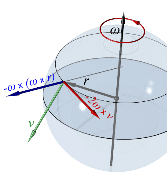

I still don't undestand how I can us my fingers to detremine coriolis direction,can you explain me with example below?I am doing something wrong...
5bEGgqZEHBMezk4w6uXn1fct6jfNktgSBs3uNobkzQGP9QTSnM79rjWG8DM2iijqa74XabL8AaZN9une293Mue1MDLtCqjHG.png
On the Northern Hemisphere, the direction of the Coriolis force can be derived with the "three-finger-rule", where the thumb points towards the rotational axis, the index finger in the direction of the velocity and the middle finger in the direction of the force. The blue vector displays the centrifugal force.
In the example shown there, v does not appear to be an east-west velocity. I thought we were supposed to be talking about an east-west velocity.
That drawing appears to depict a southward velocity in the Northern hemisphere. The green arrow for velocity points down and out. It is, of course, tangent to the Earth's surface.
The rotation vector is up out of the north pole.
The cross product of the two is at right angles to both -- it points due east. That is at 90 degrees to horizontally due south. It is also at 90 degrees to the north-south polar axis.
The velocity is south. The acceleration is east. This amounts to a clockwise deflection in the northern hemisphere as I had advised you to expect.
For the purposes of Coriolis force, the gray "r" vector and the blue centrifugal force vector can both be ignored.
The cross product of the two is at right angles to both -- it points due east. That is at 90 degrees to due south. It is also at 90 degrees to the north-south polar axis.

Can object feels coriolis force ,same as you can feel centifugal force when driving car in curve?
When birds flight to the north,they bend to the right(east),they path is curved looking from satelite which rotate with Earth speed.
Do birds body feel centrifugal force because they travel at curve,if they fly with accelometer,will he notice Fc?
If we assume that birds flight is fast enough ..
Or this is just optical ilusion which can be seen only from rotating frame,so birds fly in straight line and their body don't feel centifugal force caused by curve path?
  • #32
No. You cannot feel centrifugal force either. Nor can you feel gravity. Coriolis is the same.
What you can feel are the strains in your body as the car pushes you into the curve, or as the surface of the Earth pushes you upward against your otherwise downward trajectory.
The effect of Coriolis on birds is entirely negligible. Just as it is on you when you walk down the aisle at the grocery store.
If Coriolis deflects you a half millimeter to the right, you correct course to avoid bumping into the tomato sauce and get to the end of the aisle without incident.
If Coriolis deflects a goose a couple of inches to the right, the goose corrects course to keep on its path. It takes a leftward bank angle too small to notice in order to maintain a straight-line flight path. Birds can deal with flying in a cross-wind; Flying with Coriolis is vastly easier.
Are we talking centrifugal or Coriolis here? Either way, the effect is too small to be noticed.
We can walk on a tilting floor with no problem. We can walk away from the table after eating a big meal without any problem. We can walk away from the toilet without any problem. Those are all things that are equivalent to centrifugal or Coriolis forces -- minor differences in the magnitude or direction of the inertial force of gravity. Things that you deal with without bothering to think about it.
  • #33
Instead birds ,use missile.
Accelometer in missle will not show acceleration caused by curved path to the right?
If I am in missile which travel to the north ,will I feel same force as when car going in right turn?
  • #34
Accelometer in missle will not show accelartion caused by curved path to the right?
Again, you cannot feel any centrifugal force in a right turn. None. Nada. Zilch. Zip. Never. Ever.
What you can feel is the car forcing you to deviate from your natural free-fall trajectory. The car supports you against gravity and pushes you around the turn. The stresses from those forces are what you can feel.
An accelerometer in a cruise missile can sense the acceleration resulting when the missile's guidance system commands a slight left bank to compensate for the rightward deflection from Coriolis.
An accelerometer in a ballistic missile would feel nothing. The operator would have commanded a launch angle enough leftward so that Coriolis would result in a hit without any mid-course maneuvering.
