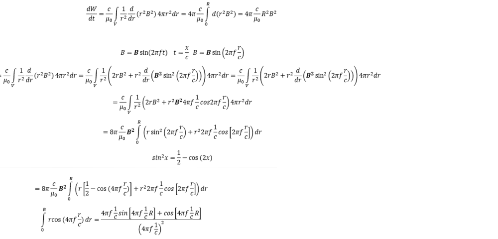

What I have done so far:
We assume that B goes radially outwards and use spherical coordinates to solve the divergence theorem:
The divergence in spherical coordinates:
$$\frac{1}{r^2} \frac{\partial r^2 A_r}{\partial r} + \frac{1}{r sin \theta}\frac{\partial}{\partial \theta}A_{\theta}sin_{\theta} + \frac{1}{r sin \theta} \frac{\partial A_{\varphi}}{ \partial \varphi}$$
Since we only have radial divergence we can obtain:
$$\frac{d W}{d t}= \frac{1}{\mu_0}\int_{V}c \nabla \cdot ( \textbf{B}^2) \textbf{i}] d\tau=\frac{c}{\mu_0}\int_{V} \frac{1}{r^2} \frac{d}{dr}(r^2B^2)4 \pi r^2 dr=\frac{4 \pi c}{\mu_0}\int_{0}^r d (r^2B^2)=\frac{4 \pi c}{\mu_0} (r^2B^2)$$
Which we see is the same result as we ended up with above as:
$$W=\frac{c}{\mu_0}\textbf{B}^2 \frac{1}{2} T 4 \pi r^2$$
But what if we instead tried to integrate
$$\frac{c}{\mu_0}\int_{V} \frac{1}{r^2} \frac{d}{dr}(r^2B^2)4 \pi r^2 dr$$
by rewriting:
$$B=\textbf{B} \sin [2 \pi ft]=\textbf{B} \sin [2 \pi f\frac{r}{c}]$$
Thus
$$\frac{c}{\mu_0}\int_{V} \frac{1}{r^2} \frac{d}{dr}(r^2\textbf{B}^2 \sin^2 [2 \pi f\frac{r}{c}])4 \pi r^2 dr$$

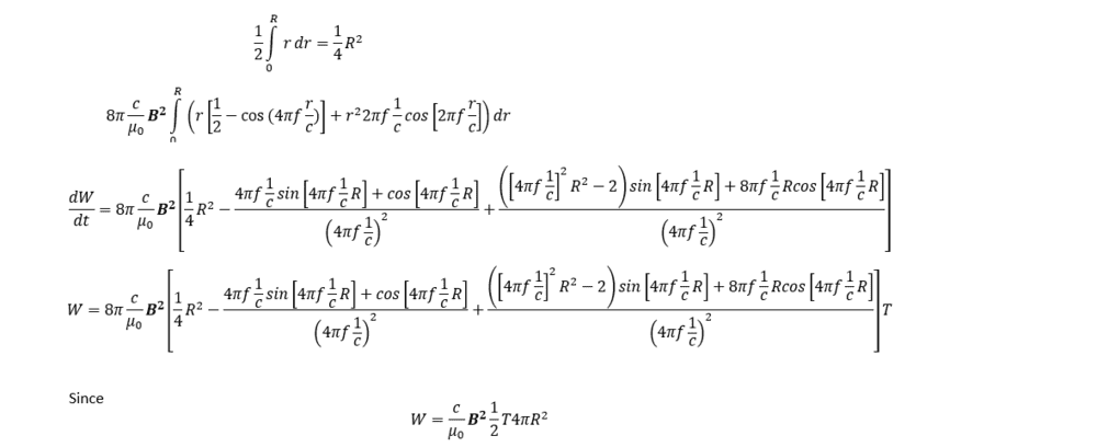

Then we have a r dependency for the integral. I have tried and I ended up with a longer expression. The better news was that if I equated it with
$$\frac{c}{\mu_0}\textbf{B}^2 \frac{1}{2} T 4 \pi r^2$$
I ended up with an equation that only had R and f as variables since B is the same for the two divergence theorems versions from the derivations above. I guess I could initially determine R from a setup point of view. But unfortunately it did not give any solutions. It seems that since there are 2 Work equations. Equating thoose two could give a solution of frequency. But I have not found a solution that makes sense. Anyone that wants to try to find a solution for the frequency with this setup?
Here is my attempt attached just in case anyone want to take a look (the answer gave me 0 answers as far as I could tell):

Maybe I'm out of the loop, but what exactly does this equation mean? It doesn't make sense to me, for starters, the RHS is a vector and the LHS a scalar...
Likes fisher garry
You can't. It's impossible to have a purely radial magnetic field consistent with Maxwell's Equations, because of ##\nabla \cdot \mathbf{B} = 0##.
fisher garry said:
I rearrange an emission of EM waves from an electrons surface
It looks like you are trying to make the outgoing EM wave spherically symmetric. It's impossible to have a spherically symmetric EM wave consistent with Maxwell's Equations; the lowest order EM radiation is dipole.
So as far as I can tell, you found an equation with no solution because you made assumptions that are inconsistent.

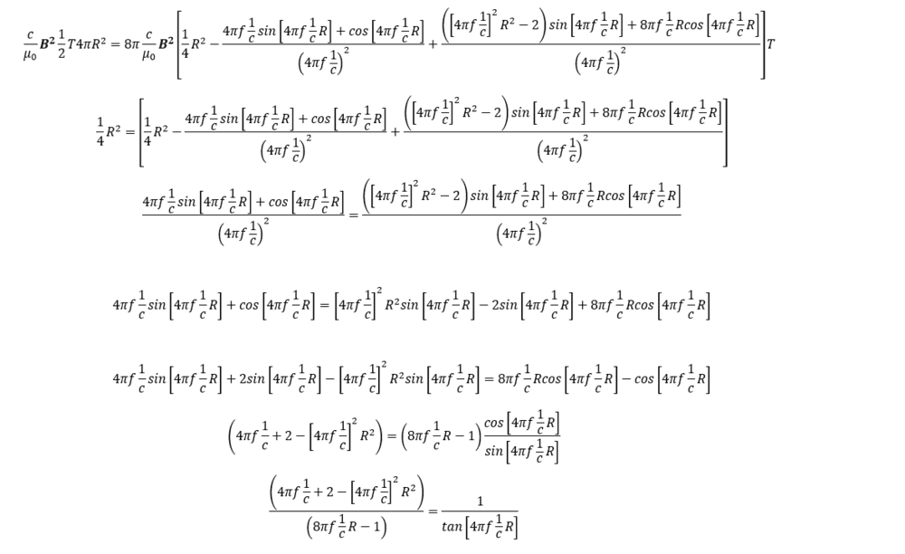

Sorry. I will write it out. Ok I could ask: Show me the values for the frequency f that is given in the equation I ended up with in my first post. Here is one attempt:
I did ponder on solving the equation with the charge radius. Since I have been told that the charge radius is where electrons emit light:
$$\frac{4 \pi f \frac{1}{c}+2-[4\pi f \frac{1}{c}]^2R^2}{8 \pi f \frac{1}{c} R - 1}= \frac{1}{tan[4 \pi f \frac{1}{c} R]} $$
charge radius:
$$R=2.82 \cdot 10^{-15} $$
$$\frac{4 \pi f \frac{1}{3 \cdot 10^8}+2-[4\pi f \frac{1}{3 \cdot 10^8}]^2(2.82 \cdot 10^{-15})^2}{8 \pi f \frac{1}{3 \cdot 10^8} 2.82 \cdot 10^{-15} - 1}= \frac{1}{tan[4 \pi f \frac{1}{3 \cdot 10^8} 2.82 \cdot 10^{-15}]} $$
$$\frac {4.2 \cdot 10^{-8} f+2-418.2 f \cdot 10^{-38}}{23.6\cdot 10^{-23}f - 1}= \frac{1}{tan(11.8 f \cdot 10^{-23})} $$
approx:
$$\frac {4.2 \cdot 10^{-8} f+2}{23.6\cdot 10^{-23} f- 1}= \frac{1}{tan(11.8 f \cdot 10^{-23})} $$
$$4.2 \cdot 10^{-8} f+2= \frac{ 23.6\cdot 10^{-23} f- 1 }{tan(11.8 f \cdot 10^{-23})} $$
Is there a solution to this?
Ok. Thanks for feedback :) If I could ask: I have a setup here with EM waves coming out of an object I would believe. I want to use the divergence theorem to find a solution for the frequency. How would the direction of the EM waves be in order to be able to use this setup? Thanks :)

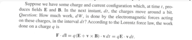

This is taken from introduction to electrodynamics by Griffiths which the rearrangment of the maxwell equations are taken from. I will rewrite what it says there if it is ok:
Suppose we have some charge and current configuration which at time t, produces fields E and . In the next instant, dt, the charges move around a bit. How much work dW is done by the electromagentic forces acting on these charges in the interval dt? According to the Lorentz force law, the work done on a charge is.So I guess it could be any charge contribution. For example an electron. Peter Donis did use the relation that ##\nabla \cdot \mathbf{B} = 0##. But at the same time electrons emit EM waves from deacceleration for example in hydrogen molecule. So would there not then be a setup for using the divergence theorem then if some EM waves are coming out of the electron? And if so how would the spatial arrangment of the EM waves be?
That question is about work done by EM fields on charges. Is that the question you are trying to answer?
If it is, pretty much everything else you have written in this thread up to now is irrelevant.

I have already told you where your first post fails: you are making inconsistent assumptions, so of course you get nonsense answers. That is true regardless of what question you are actually trying to answer.
If you want to know why everything you have written is irrelevant to the question about work done by EM fields on charges, that should be obvious: because nothing you have written has anything to do with work done by EM fields on charges. It's all about some inconsistent assumptions about radiation.
Likes etotheipi
@fisher garry I am closing this thread because there is nothing here that can serve as a useful basis for further discussion. I would recommend taking some time to think carefully about what you actually want to know so you can formulate a better question if you want to start a new thread.
