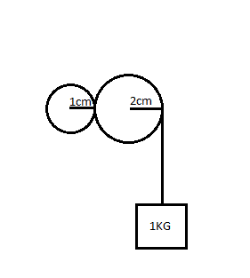

Apologies I should have included a diagram, please see below:
This is what I was referring to with the calculation: 1KgF x 1cm = 1KgF.cm = 0.098 N.m of torque
As for the motor, by "Max Load (holding)" I meant the max torque output is 0.098 N.m
As for the gear coupling, see below:
A motor with T = 0.098 N.m drives Gear1(1cm) which impact onto Gear2 (2cm)
Hope that clarifies the question :)

In that case we have R2 = R3 = 2cm and R1 = 1cm so plugging those into the formula above we see that the upward force on the weight is 9.8N which is what is required to keep the weight from falling.

That is not how you build a gear box, to lift heavier weights.

and that's probably why I'm confused - All the YouTube videos 'introducing' the concept of gears display the configuration like this. So how ARE they coupled to achieve greater lifting strength?
It just didn't make sense to me how simply having a bigger gear next to the first one would amplify the torque. When we can clearly see here that a larger radius requires more torque to move the same 1Kg weight.
Required torque = 1KgF x 1cm = 1KgF.cm = 0.098 N.m of torque
Required torque = 1KgF x 2cm = 2KgF.cm = 0.196 N.m of torque
The only thing I can see happening with the configuration in my last post is it wouldn't be able to hold the weight anymore. Would you agree?

instead of wrapping the cord around the outside of the large cog, wrap it around a disc that is locked concentrically to the big cog but has a smaller radius. That way R3 << R2 and the lifting force can be much greater.

Think of it like a lever. You get more force at points near the fulcrum. You always need the concentric bits to change torque.

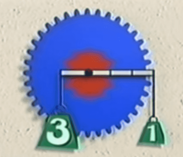

This doesn't seem right..
In the video it states that to balance the gears you would apply a second equal weight to the blue gear.
The blue gear has 3x the rim force. Meaning for the gears to balance in this case, the red gear would need a weight of 3Kg, right? So again, your motor has to do 3x the work to lift the same weight.

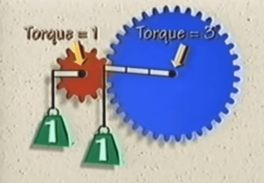

This however does make sense:
So in effect, you build up a gear train with different size gears to try maximize that 'lever' length?
The blue gear has 3x the rim force. ...
No, that would violate Newton's 3rd Law. The rim forces between meshed gears are equal, but opposite.

Luchekv said:
In the video it states that to balance the gears you would apply a second equal weight to the blue gear.]
The diagram is balanced with no additional weight. Any torque multiplier that the weight on the larger gear has is exactly canceled by the torque multiplier that the smaller gear also has on the larger gear. The result is exactly as though the second weight was attached directly to the smaller gear. So the torque on the smaller gear is exactly 0.
