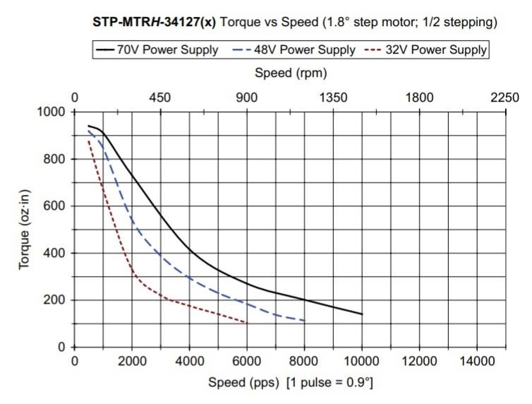

When you have done that, you can start looking at stepping motors. Stepping motors have a torque vs speed curve that you get from the data sheet. As an example, here is the torque curve for a particular stepping motor rated at 1288 oz-in holding torque:
The selection of a stepping motor is not just selecting a motor. It is selecting the motor, drive, and gear reducer system. Study the stepping motor catalog and data sheets carefully, The catalog for this motor states that you need a 100% safety factor on motor torque. Because of the number of variables, the process is iterative. Stepping motor catalogs normally have a lot of good information on the selection process. Plan to spend several hours, or more, reading stepping motor catalogs after you have defined accelerations and speeds as indicated in the post by @Baluncore.
