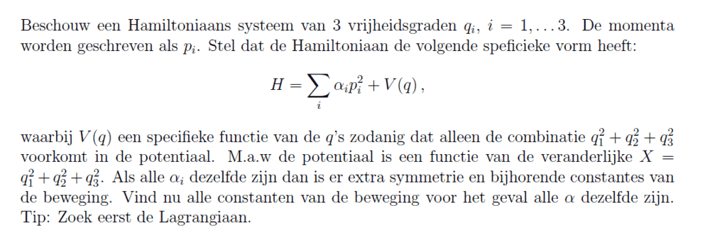

Consider a Hamiltonian of ##3## degrees of freedom ##q_i, i = 1,...3##. Momentum is given by ##p_i##. Suppose that the Hamiltonian has the following form:
$$H = \alpha^i (p_i)^2 + V(q)$$
The only possible combination of ##q_i## given by the potential function ##V(q)## is ##q_1^2 +q_2^2 +q_3^2##. We can apply the following change of variables* ##X = q_1^2 +q_2^2 +q_3^2## and obtain the potential in function of the new variable: ##V(X)##
If all ##\alpha^i## are the same, then there is extra symmetry and corresponding constants of motion.
a) Find all constants of motion in case all ##\alpha^i## are the same. HINT: Find the Lagrangian first.
EXTRA (which means I added it; we can deal with this after solving a)):
b) Why all ##\alpha^i## need to be the same?

I do not understand the following sentence (particularly, the concept of extra symmetry): 'If all ##\alpha^i## are the same, then there is extra symmetry and corresponding constants of motion'.

This is an old exam question. I am working out exercises to practice for a test. The original copy (in Dutch though...):
I am still thinking how to find all constants of motion out of the Lagrangian.
