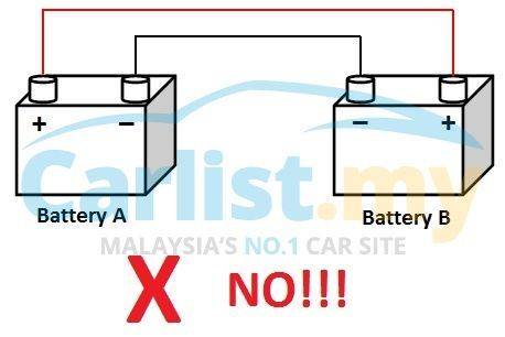

Car A has a dead battery and car B gives a jump to it. I connect the positive of battery B to the positive of battery A and the negative of battery B to the body of car A.
1. Am I essentially creating a separate circuit by choosing a different ground than that of battery A? How is the current flowing back to battery B?
2. How many such separate circuits are theoretically possible ? For example, let's say , battery B is not strong enough, so I leave the connections as they are and bring battery C. I connect the positive of battery C to that of battery A (and of B). Where could I connect the negative of battery C for this arrangement to work?
Thanks

It's not so much 'where' but 'how well'. The ground connection of the starter motor will be good as it's straight on to the engine block. Your dying battery may be suffering from poor connecting leads to the starter and the engine block. If the connections are ok then why not connect your jump battery right across the old battery? If they aren't then unscrew, clean and re- connect all the terminals. Frayed or corroded cables should be replaced - but that may not be possible in a First Aid scenario.
Just to clear things up, the two batteries should be in parallel. Every ground connection will effectively be to a common node and so should all the + leads. The jump battery should, ideally, be in a car with the engine running. Charge should flow into the dead battery and its volts should soon reach a proper charging value. After connecting the jump battery, wait a minute or so for the running alternator to perk up the 'dead ' battery (give the engine a few revs above idle) and keep the jump engine at that speed whilst you try to start the casualty.
Current flows from the body of car A to the negative of battery A via the big earth/ground strap that connects them. The reason you make this last connection is so that the spark formed when the circuit completes is away from the flammable battery gases, You should disconnect in reverse order for the same reason.

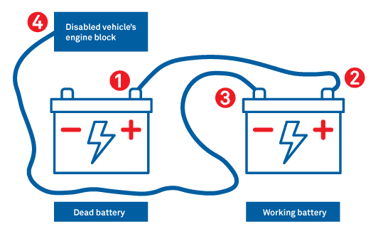

I looked up a trusted brand of battery, and sought their safety info.
https://www.yuasa.co.uk/info/technical/health-safety/
I refer you all to sections D (gases) and E (jump start procedure). It confirms what I say, apart from suggesting the final jump connection could be directly to the -ve terminal, or to an earthed point. Every set of jump leads I have ever bought has said in the instructions “NEVER [capitals] make the final connection directly to the negative terminal”.
Another reference: https://www.theaa.com/breakdown-cover/advice/using-jump-leads
And another, for good measure: https://www.rac.co.uk/drive/advice/car-maintenance/how-to-jump-start-a-car/
Also note that modern smart chargers will not supply power until connection is made, often called ‘arc avoidance system’ or similar. Page two, under heading, ‘safe and easy to use’:
https://www.ctek.com/storage/ma/4e122ff2ca2147d89202d8ce2561386c/9549cddce9a64a7f8752932183162ee0/pdf/848FDD68BDE3402BA016C77F4B49B72A1C634710/MXS_5.0-productsheet-low-UK-EN.pdf

Every time I've jump started a car, I've always connected the jumper leads battery terminal to battery terminal, I've never used the chassis as negative, maybe because all the bits are usually coated in thick oily goop we put all over everything to stop them instantly rusting here with all the salt on the roads. The boosting car should be running before you make the connection unless you want to end up with two stranded vehicles. Once connected its help full to run the boosting vehicle up to a couple k rpm so the alternator is actually delivering some power, they are not the best at idle. My old diesel truck could not be jump started over a cable, the boosting vehicle had to get enough charge into my battery before the old donk would even turn over (something something high compression ratio something).
Then load dump. This is a very specific thing: the battery disconnecting from the charging circuit under heavy charging load. The battery acts like a large zener diode, so unless your battery is so dead its not there at all electrically, you will not be creating load dumps in your car when disconnecting the boosting vehicle. Then, all the electronics in a modern vehicle are designed to with stand a load dump, no OEM in their right mind will put some bit of electronics on that that has not passed those tests!

Unfortunately for me I don't generally listen to instructions that make no sense to me, so this line would make me question their guide lines significantly: (from AA link)
"Keep both engines off and wait for 3 minutes, then start the working car’s engine and let it run for 1 minute."
To me this makes no sense, if the dead battery is dead, you now have two large loads on the good battery, then waiting, esp depending on the fault in the bad battery could easily mean no dice starting the good car.
Maybe these guys are scared of a little arc when you connect or something, generally not a problem for the car even if the bat is completely gone because of all the accumulated capacitance on the B+ bus from all the connected ECU's.
Every bit of electronics in a modern car can hold the clamped load dump voltage of 40V. Almost all cars now use a central clamp to limit this voltage to 40V rather than older alternators which would hit nearly 100V. Generally this is done in alternator rectifier, the diodes are Zeners, so they limit the output voltage under load dump.
I'm sure there are many different ways of connecting the two cars to boost and an infinity of instructions in between.
I've always done this, I not going to claim it right or wrong, but had zero problems with everything from old diesels to modern luxury cars:
Good car idling
Connect positives on both sides (bat terminal to terminal)
Connect negative on both sides, (terminal to terminal) you should hear the running car take up a bit of load.
Rev good car to 2-3krpm for a bit
Crank car with dead bat
Disconnect with both running.
I suspect those instructions on AA are done in such a way that they cover their rear ends in case of anything ever going wrong anywhere and someone blaming their instructions.
