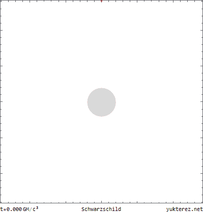

Particles in free-fall follow geodesics. There is no other effect here. In particular, gravity as modeled by GR doesn't cause an acceleration in most senses of the word. It just modifies the meaning of "straight line" in Newton's first law.
The paths of light in the observer's frame of reference are
as you can see the speed of light is not constant, but shapiro-delayed (infinitely, at the horizon; only the local velocity is constant). If you took high velocity particles instead of photons, for example with 0.99999c local initial velocity, you would see no difference on the plot because the deflection and shapiro-delay would be almost the same.
Likes Ibix and PumpkinCougar95
