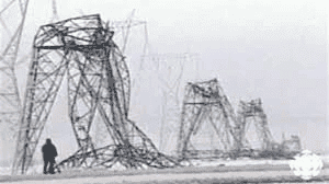

Power grids are filled with holes that all line up on a regular basis.
https://en.wikipedia.org/wiki/List_of_major_power_outages
At 2:44:16 AM on March 13, all was well and power engineers at Hydro-Quebec resigned themselves to yet another night of watching loads come and go during the off-peak hours. The rest of the world had finished enjoying the dance of the aurora borealis, and were slumbering peacefully, preparing for another day’s work the next day. The engineers didn’t know, however, that for the last half-hour, their entire system had been under attack by powerful Earth currents.
http://www.solarstorms.org/SWChapter1.html
One second later, at 2:44:17 AM, these currents found a weak spot in the power grid of the Hydro-Quebec Power Authority. A 100-ton, static VAR capacitor Number 12 at the Chibougamau sub-station tripped and went off-line as harmonic currents induced by the electrojet flowing overhead, caused protective relays to sense overload conditions. The loss of voltage regulation at Chibougamau caused power swings and a reduction of power generation in the 735,000-volt La Grande transmission network. At 2:44:19 AM, a second capacitor followed suit at the same station. 150 kilometers away at the Albanel and Nemiskau stations, four more capacitors went off-line at 2:44:46. The last to fall at 2:45:16 AM was a static VAR capacitor at the Laverendrye complex to the south of Chibougamau. The fate of the network had been sealed in barely 59 seconds as the entire 9,460-megawatt output from Hydro-Quebec’s La Grande Hydroelectric Complex found itself without proper regulation.

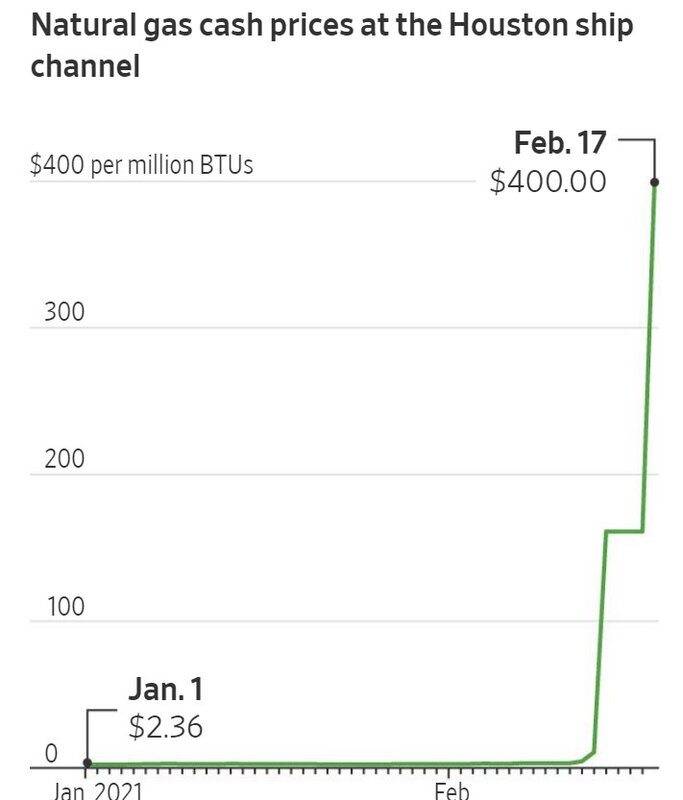

But it wasn't just power plants. Natural gas pipelines, oil refineries, and city water systems, also shut down because of freezing. [EDIT: Therefore, some consumers who heat their homes with gas were left to freeze. Customers can provide for gas furnaces that can operate without grid electricity.]
Within the competitive Texas power market, there is a strong incentive for generators to keep costs down to recoup their investments. The rapid buildout of wind and solar power, which are now among the cheapest sources of electricity, have pushed prices even lower in recent years, making it more difficult for gas and coal plants to compete.
That touches on the destabilization of markets that I talked about in the 2019 PF Insights article. https://www.physicsforums.com/insights/renewable-energy-meets-power-grid-operations/

There was still a whole slew of other problems to deal with across the province . The ice was 3 - 4 inches thick, with some places much much more, downed HV power lines, and bent trees onto the lines.
So even if the Texas system is 'designed for the hot summer months', and failed in the winter, the Quebec system, 'designed for cold winter months', also failed in the winter.
Several areas, without power for months, mainly the Eastern Townships, would be akin to what the Texans are going through.
https://www.inmr.com/looking-back-on-the-great-ice-storm-of-1998/
Images example
https://www.google.com/search?q=quebec+ice+storm+images&rlz=1C1KMZB_enCA593CA862&tbm=isch&source=iu&ictx=1&fir=uHhpqtGfuiW7aM%2CCPY5pdVrOC7dFM%2C_&vet=1&usg=AI4_-kT0E0DVsMK1NGmTopYeJsFuAjVcaQ&sa=X&ved=2ahUKEwiu3NbxsPnuAhWgGFkFHZ7_DsEQ9QF6BAgFEAE#imgrc=uHhpqtGfuiW7aM
