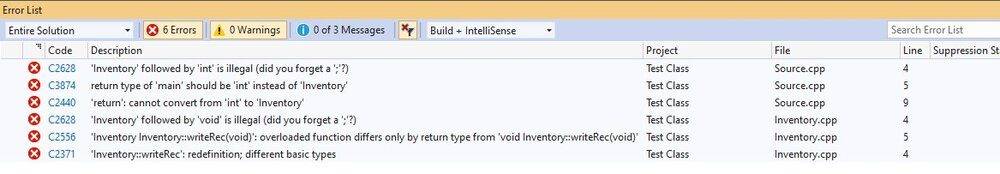

Can anyone see what I did wrong? Here is the error list:

The error messages in C++ are sometimes not very helpful, but at least the error message asks "(did you forget a ';'?)". That's the clue.

You are missing a ';' in the green box I made;
Note that include just does a copy and paste. So this is what the compiler is trying to compile.

The compiler didn't complain about Inventory.h because the contents of this header file were merged into Source.cpp before the compiler saw it. The effect of a preprocessor directive such as #include "Inventory.h" is that all of the text in that header file gets merged into the file that contains the include directive.
The first two errors you showed in post #1 were due to the compiler seeing something like this in Source.cpp:

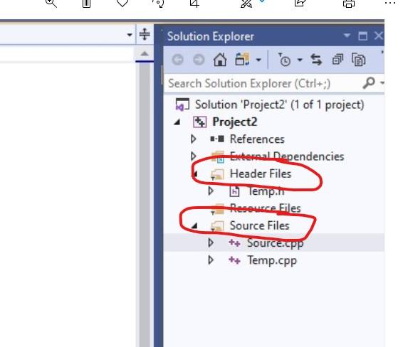

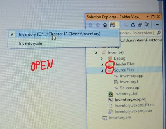

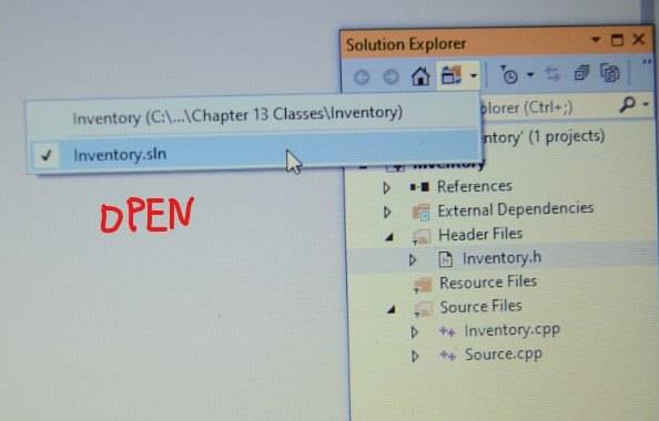

I have a question about Solution Explorer. Before I really messed up the .sln view 2 days ago, it used to look like this, AND it worked when I put the .h file in the Header Files folder, .cpp files in Source Files folder. With the external folder path typed in, it will work with both Add-->New and Add-->Existing from external folder.
But, of cause, I screwed up, I managed to delete both the Header Files and Source Files folders. I added back those folders in and name them exactly the same. BUT it doesn't seem to work the same. For one thing, if I create the .h file and put it in the Header Files folder, compiler cannot find it. I have to delete the .h from Header Files folder and put it in the Source Files folder as shown below. Then it will work.
What is the difference? If it is different, how can I get back the original Solution Explorer with those folders? The sickening thing is VS REMEMBER all my mistakes, I screwed up in one project, that screw up reflects on ALL the other projects. Everything is screwed up. Is there any way to make it so whatever I do, it confines to the project opened at the time and won't affect the others?
Thanks

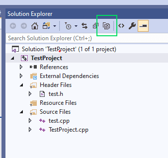

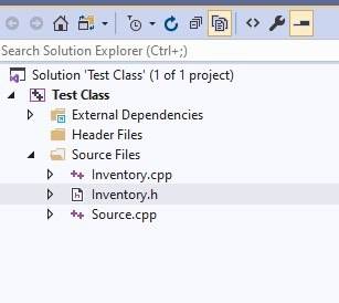

Those "folders" are not actually folders in Visual Studio. They are just filters. The "Header Files" filter contain this filter
Code:
h;hh;hpp;hxx;h++;hm;inl;inc;ipp;xsd
Right click on Test Class > Add > New Filter. From the new project template, "Header Files" Filter should be like the one I just wrote.
Your files, header and source files, should be safe in your computer and you can search it through the explorer. For basic use you can just put all .h and .cpp files together in one folder, and then import (add existing item) them into Visual Studio if you have some files written outside Visual Studio.
I am not a fan of Visual Studio myself because it's slow and can get confusing for new users, even for just the solution explorer. To get the original folder I think you can just recreate a new project and copy all .cpp and .h files without using Visual Studio, and then import them to Visual Studio. For example I did create a test project called ConsoleApplication1 and the project layout looks like this:

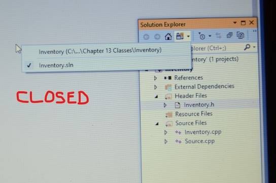

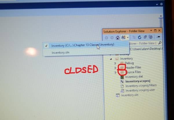

Thanks Gregory112 for your reply.
When you said project template, do you mean (2) I point to? I don't know those names.
Do you mean the Header Files (1) below is actually a filter?
I followed your instruction, I right click to Test Class in (1) above and get this menu. I don't see New Filter option.
Confusing is an understatement with VS, this is the 3rd day I am on VS solution explorer, not in C++. I don't follow about your creating a test project ConsoleApplication1. Do you mean you created a folder called ConsoleApplication1 somewhere in D drive in the computer. You put all your .h and .cpp files in it. Then you use Add-->Existing folder and import into VS? How do you do that as there is no option to import a whole folder?
I still have a long way to learn VS.
Thanks

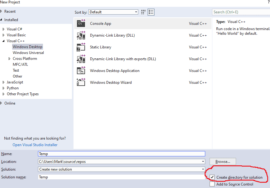

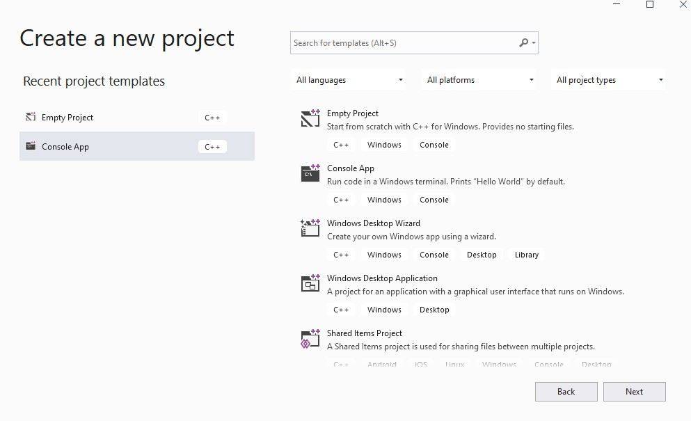

What I mean by project template is when you try to create new project. In there you can search for a C++ template, and I chose console application, which you should be choosing too if you just want to make some test C++ projects.
I think we are using different Visual Studio version, I am using 2019.
Yes, but what I did was I created the project from VS first, to let VS created all the necessary folders. For newcomers, a C++ project do not actually have obligatory directory structure, but VS created many different folders that some of them I do not know what for. After creating the project you can then move your source files inside the newly created project folders and add existing items, instead of adding existing folder because that may recreate redundant folders.
When creating new project, no need to check the "save solution file together with project files" (I forgot the exact wording of this option). This will make VS create a folder the name of your project, and will then create a directory structure similar to what I told you before.
Why is is complicated? Because a solution in VS can contain multiple "subprojects" in it, that is why there are a lot of folders and hierarchies.

I believe what he meant was the dialog that opens when you create a new project. You fill in the fields with a name for the project. In post #18, the first image you show is after a project has been created.
Sort of. All of the headings that show up in Solution Explorer are described in the file with suffix .vcxproj.filters. For example, if the name of the project is Temp, there will be a file named Temp.vcxproj.filters. There will be another file named Temp.vcxproj. In VS 2017, which is what I'm using, the vcxproj file contains information about what files make up the project and how they will be built to produce the final product.
More information on project filters is here: https://docs.microsoft.com/en-us/cpp/build/reference/vcxproj-filters-files?view=vs-2019.
All I did was to do a search using vcxproj filters as the search key.
It would be good if you started doing more searches like this.
If you select Test Class, then right-click, you will see Add --> New Filter. Since you already have the Header Files and Source Files "folders" (they're not really directories that you would see in Windows Explorer), I can't think of any reason you would want to do this, unless you had somehow deleted these "folders".
When you create a new project, you fill in a name for the project. The default name for this type of project is ConsoleApplication1. If you check the small box that says "Create directory for solution", VS will create a top-level directory named ConsoleApplication1, and a directory under it that is also named ConsoleApplication1. In Windows Explorer you can copy your .cpp files and .h files to that 2nd-level directory, and then Add--> Existing item using Solution Explorer.
If you already have a project names ConsoleApplication1, the name in the dialog template will be ConsoleApplication2, and so on. It's usually not a good idea to use the default names for your projects -- it's better to come up with a name that suggests what your project is going to do.

Thanks for the reply.
I tried creating a new project with console application. It came with ConsoleApplication1.cpp that say "Hello World". Why is it preferrable to do test program with console application? I still don't see the option to Add--> New Filter.
I am using VS 2019 the latest one as I just installed it 3 weeks ago.
It is not that I want to create new folders( filters), I accidentally deleted them. My mouse/computer is funny, when I highlighted a line to delete, sometimes it highlight the following lines while I hit the delete. It's too late when I notice that and the next line got deleted. In the code, I can hit Ctrl-Z to get them back, it DOES NOT work if I deleted the folder in the Solution Explorer view. I must have deleted the Source Files and Header Files folders(filters) by accident.
That's really not a serious problem if I can just create a new project and copy all my .h and .cpp files over. BUT the STUPID VS...I repeat...THE STUPID VS remember what I deleted. If I create a new project, the Header Files and Source Files folders are also GONE. Even when I open an old file that had the folders before, they are GONE.

When I create new project, these are the two page I get:
Then when I click one of them, this will come up. There is no option for that. Only option is circled in red and it will not do it.
It's not that I clumsily deleted the folders, it's the mouse/computer combination that when I choose say the .h file to delete, sometimes it will highlight the other stuffs, when I hit the delete button, it's too late.I know the same folders are gone in the other projects because when I open the old projects that were working and had the folders, they are gone. VS remember the actions I did and put it in other files. When I try to create new project, those folders are NOT there also. That's why I am so mad with VS. No other program I know of do that. Whatever you messed up, close the program and you can start over again. Not VS.

The folder is gone in the VS Solution Explorer view. I could swear when I checked one of the old project and the header files folder was gone with the .h file and when I ran the compiler, it failed because it's missing the .h file. It was so fast I don't want to say it's 100%. But I am sure those folders are gone in the old projects where they were there before.
You don't know my mouse, it's crazy. I caught a lot, but somehow every so often, it slipped by me. My question is why VS is like this? Why when I made a mistake deleted the folder, it will reflect on all the other old projects and the new that are going to be created.
Thanks

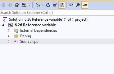

No I did not say I delete things haphazardly, it was always the same problem.
I just copy two Solution explorer from project at least over a month old in chapter 6 and chapter 9:
Both folders are GONE. This is how VS work all along. You don't know that?
I never thought about changing the mouse because it is NOT a problem with any other programs That I use, everyone one of them just restart from the beginning when I close the program and re-open it. Or just as simple as Ctrl-Z to get back the deleted stuffs. Only VS remember what was done to it from before and there is no Ctrl-Z. Like I said, I use plenty of programs from free ones to 10K+ programs through out the years, never have I once encounter this. Don't tell me this one is special. I ran programs with 3D electromagnet simulations, don't tell me those are not as sophisticate as this one.
Also, all the other programs, when I run something, they always start from scratch, never have I even encounter a program that will screw up, have to Rebuild Solution or Clean Solution to reset and clear things or else it will give funny result. It's to the point I automatically rebuild solution before I run Ctrl-F5.Just go to any Window explorer, delete a file, hit Ctrl-Z, the file will come back. Just not in VS.

NO, accident delete something is NOT a big deal if Ctrl-Z can recover. Usually the worst case is create a new project and copy over the files and delete the damage project. But VS do not allow you to do that, the damage will follow to the new project and affect all the old project just sitting there.
I am surprised you don't know that. I notice that in the first installment of VS2019, then there were too many problems and from you advice, I delete and reinstalled VS2019 the second time like 3 weeks ago. It sure works better. BUT this changes in one project ripple to other projects are always there...Of cause I could have done something wrong again.
Yes, this is a NEW project I just created to show you. No Header Files and Source Files folder. This is all I have:
VS remember I deleted the folders and it WOULD NOT show up when I create a new project.
