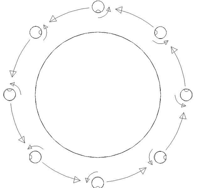

I am also toying with the idea that the planet should not be quite tide-locked, but has a very slow day/night cycle (i.e. thousand plus years), which presumably would also have some effect on the volcanicity (as well as providing for come ancient civilisations to have moved into the dark side.)

If not, I think there definitely needs to be a very slow (thousand year plus) rotation of the planet relative to the primary (so it's not quite tide-locked) so as to have some of the older civilisations drift into the permenant night zone.
It would fit well with the "just RCB star"-scenario. The planet would need to orbit the star with about 1600 year period, and if it wasn't fully locked, it could have almost any period of "day/night" cycle(speaking of the RCB star raising and setting, not the dimming).

So, I had another think... It occurred to me that a rotating moon could be usefully used. If there is a large, dark feature (perhaps an impact crater or old volcanic activity) on the surface, we could the "the eye of the moon" which could have all sorts of interesting implications. (Also, it provides a get-out clause either way on the moon rotation, ebcause you could say it was either still rotating from the capture, or because of the impact.)
Further, if it's a fairly slow rotation, that could be used as the basis for the Andorlaine equivilent of "year" (I (somewhat arbitarily) 184 orbits (@ 6 earth-days) which gives you 1104 days = roughly three years).
Granted, I was considering something that a multiple of six (because I still want to use hours/minutes ("day") so that a) my players don't go too mad and b) I don't have to re-write too many rules!). (Then, you see, six becomes a number of importance (6 x 10 secons in a minute, 6 x 10 minutes in an hour, a sixth of a moon orbit is a day (itself 6 x 4 hours) and then 6 x [something] is a "year". (And 6 x 6 x 10 degrees in a circle...!)
But on the other hand, I try not to make things too neat, so I'm still thinking about that one.
180 (orbits to 1 rotation, so 1080 Earth-days to one rotation) would probably be the most significant number it could be without being too long, but like I say, I think that might be slightly too neat? What do you think? Would that seem to be pushing credibility a bit to have the rotational speed synch that neatly?
Still need to fix the density of the moon, though (while trying to keep the albedo pretty high - need to have a look and see if there's any other at not-ice moons with a fairly high albedo otherthan Luna.)
I've also had another look at global temperatures. I looked up a few analysis of what would happen to a tide-lcoked Earth (I found one or two) and the temperature ranges (which were not identical) where about 60-80 degress (K or ºC) between the hot and cold poles, with a bit of a bias towards the hot-side.
So I've revised my really, really ballpark figure of average temperatures to +20 over global average at the poles (as before, so about 40º C) to -40 at the cold pole (thus about -20ºC). There is a suggestion that the surface of the sea may not be frozen, due to convection (and or salinity). Not sure on that one.
Slow rotation is going to be problematic because of tidal torques. Moon, for example, has free libration period of 1056 days.
Vesta is rocky, and pretty bright. But also dense - slightly denser than Moon.
  • #35
Why is that a problem for slow rotation specifically (as opposed to fast rotatation or tide-lock)? Other than inducing some eccentricity to the length (but ones that most primitive civilisations are probably either not going to notice, or if they are appeciably skilled astronomers (like the Mayans or something), add in the odd leap-time-unit to keep their calendar synched to the moon like we do?
Still a bit low, really needs to be at least 0.3 to be as bright as luna from the surface (according to my apparent magnitude calculations spread sheet).
So, I think here we can cheat a bit, since there's really no way to get a high albedo without ice (and as Bandersnatch rightly pointed out, at those temperatures. it ain't happening) or an atmosphere; which opens a whole host of other problems I'm not sure I want to tackle! I'm having enough trying to work out what Andorlaine's wind patterns are going to be like, seeing as there is suggestions that it might have a Venus-like pattern and/or a huge hurricane on the substellar point...!)
So, we'll say that the surface has a particularly high concentration of magnesium (which may have been desposited from being dissolved in surface water/ water ice before the moon spiralled inwards got captured, and thus left behidn when the water photodissociated. As magnesium (well, magnesium oxide) has a high albedo (0.96 diffuse), I can say there's enough to raise the albedo to say, 0.4, especially there's also a high concentration of silver (as my very early thoughts had gone to) as well. We'll call the overall denisty 3650 (higher than Io), which puts the tidal acceleration at 98% of Luna. (Which, as we established, isn't going to significantly un-tide-lock the planet.)
