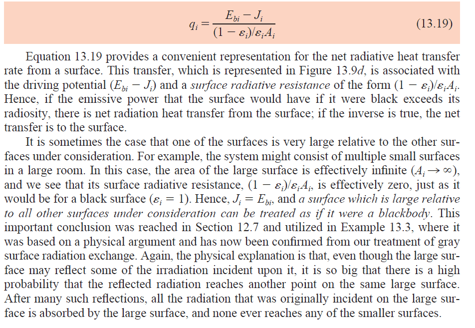

I'm referencing this equation from Fundamentals of Heat and Mass Transfer. It suggests that net radiation to a blackbody is zero because Ebi=Ji and ei=1.

In that equation, Ebi is defined as the emission from a perfect blackbody and Ji is the radiosity.

The equation is used to find the net radiative heat transfer to a given surface. It is typically used when modeling radiation systems as resistive networks. Ebi is the emissivity of the surface were it a blackbody while Ji is the actual radiosity of the surface. ε is the emissivity of the surface. For a blackbody, Ebi = Ji because nothing is reflected and everything is absorbed. Therefore, it would mean that this net radiative heat transfer would yield zero but that doesn't seem to make sense.
That isn’t possible. Emissivity is unitless and radiosity is in units of W/m^2. You cannot subtract a radiosity from an emissivity.
Also, what are the subscripts i and b? I assume q is heat in Watts, but it would be nice to not have to assume, and since you haven’t indicated what i means then I really don’t know what qi is.
Also, what are the assumptions made in the derivation of this equation?
For a black body both the numerator and the denominator are zero, so the equation is undefined. One of the assumptions in the derivation as given in the link from @Lord Jestocost is that the surface is gray. So it makes sense that the formula would break down for a black body. This is not telling you that a blackbody cannot get hotter, just that you need to use a different equation for a blackbody.
