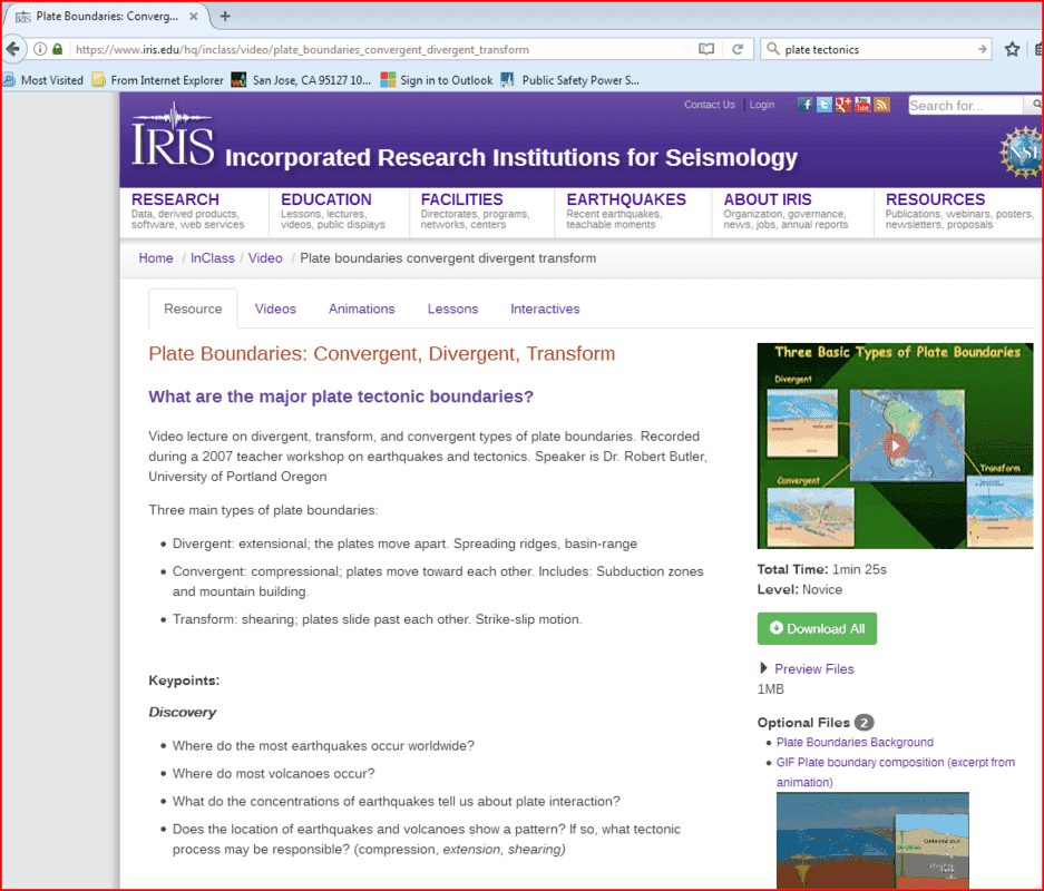

Berkeman, I know that there are a lot of movements of the Earth's crust, such as: tectonic plate expansion, day / night variation, earthquakes and other geological transformations of the crust, but the measurement of the Earth's terrestrial tide caused by the Moon ( and Sun) is what interests me.

on some of your comments and questions:
- movements of the crust due to plate tectonics? no effect at all, 5 cm/year max, 2 cm/year more typical.
- tectonic plate expansion, day / night variation, earthquakes and other geological transformations of the crust? insignificant over the course of days, or weeks, or years.
