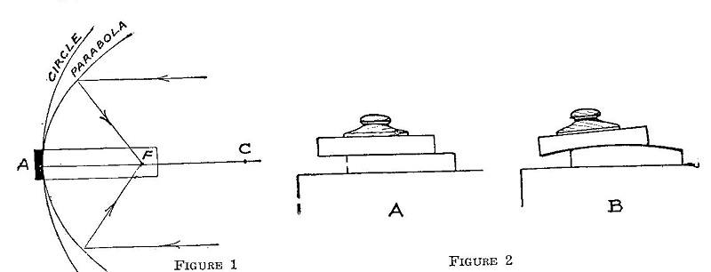

The good old resource on telescope making, apparently written some time in the 1920's, is Amateur Telescope Making, edited by Albert G. Ingalls. It is still available from Amazon as a three volume set. The figure below is from page 1 of Volume 1:
A concave mirror is made using two pieces of glass, one for the mirror and the other for the lap. Grinding compound is placed between the two pieces, and the mirror moved back and forth while walking around the lap and slowly rotating the mirror. The increased pressure during the overhang portion of the stroke preferentially grinds the outside of the lap and the inside of the mirror. Since the grinding force on the lap is equalized by walking around it, and the grinding force on the mirror is equalized by rotating it, they will be rotationally symmetric and form a portion of a sphere.
Further in the books, it is discussed how to get the desired parabolic mirror accurate to a fraction of a wavelenth of light. All of this uses technology available to Galileo, so this may well be the same techniques that he used.
There was a time when I had thoughts of making a telescope. After reading these three volumes, I changed my mind. But it was interesting reading.
