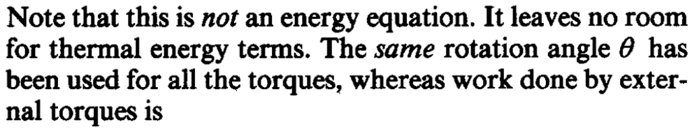

Near the end of this paper, Sherwood presents a rotational analogue of the centre of mass work equation. The derivation is as follows (##\tau_{i, \text{CM}}## is the torque of the ith force about the centre of mass): $$\sum_i \tau_{i, \text{CM}} = I_{\text{CM}} \alpha$$ $$\int \left( \sum_i \tau_{i, \text{CM}} d\theta \right) = \int I_{\text{CM}} \frac{d\omega}{dt} d\theta = \Delta \left(\frac{1}{2}I_{\text{CM}}\omega^2 \right)$$ I have no issues with this derivation. However, he then goes on to say that the actual work done in the centre of mass frame is $$W = \sum_i \left( \int \tau_{i, \text{CM}} d\theta_i \right)$$ The first derivation is only valid in the case that the body is rigid, since otherwise ##\omega## and ##\alpha## are not defined. This means that the power of any given torque is ##P = \mathbf{\tau}_i \cdot \mathbf{\omega}##, where ##\omega## is the angular velocity of the rigid body (regardless of the angular velocity of the force). And if the body is no longer rigid, then the first derivation doesn't apply anyway.
The second equation also relies on the assumption that the material being acted upon by the force also undergo angular displacements of ##d\theta_i##, since that is how work is defined. In the case of a rigid body, then all the angular displacements ##d\theta_i## must be equal.
So I struggle to see why these two equations would ever be different? Would you agree with my interpretation above? Thank you!

Sorry for not making myself clear! I refer to the second and third equations I have written. He says this about the former,
and then presents the latter equation. I would argue that for a rigid body, the former formula is equivalent to the latter formula in that both will compute the work done by external torques. The reasoning being that the angular velocity is common to all points on the rigid body so the power of all forces will end up only depending on the magnitudes of the torques.
If we're no longer dealing with rigid body dynamics but instead are dealing with something like a system of particles, then there is a difference between them since only the latter equation will apply.
I just wonder why he presents them as different formulae. The first appears to just be a special case of the latter in the case of rigid body motion?

We are no longer dealing with rigid body dynamics. The last equation has ##d\theta_i## in it which allows for the ##i##th and the ##(i+1)##th particles to have different angular separations w.r.t. the CM. Index ##i## does not appear in the previous equations that are, as you noted, appropriate for rigid bodies.

Right, yes. Thanks for clarifying. The latter equation applies to both rigid body dynamics and more general systems of particles, whilst the former is a special case of the latter only applicable if rigid body dynamics applies. Both give the actual work done in the CM frame.
I just found it odd why he noted that the former equation was not an energy equation. It most definitely is equivalent to the actual energy equation for rigid bodies.

He explains that in the next sentence, "It leaves no room for thermal energy terms". Such terms could be generated if the ##i##th and the ##(i+1)##th particles rubbed against each other as they moved relative to each other. The relative motion necessitates different angular displacements. The friction between the two would generate heat which would increase the internal energy of the system. So what he's saying is that the previous expressions are too restrictive to allow for total energy conservation in cases where internal friction between components of the system generates heat.

Interesting, thanks for clarifying! Internal forces can indeed do work on a non-rigid system.
I guess the distinction is still a little arbitrary, since we consider rigid bodies to have no thermal energy so the former equation is still a valid energy equation for rigid bodies.
