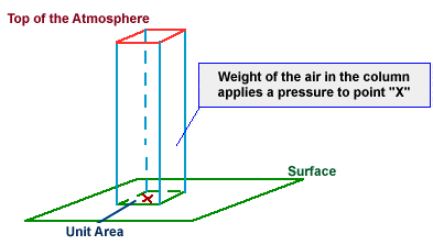

Atmospheric Pressureforce exerted by the weight of the air
Atmospheric pressure is defined as the force per unit area exerted against a surface by the weight of the air above that surface. In the diagram below, the pressure at point "X" increases as the weight of the air above it increases. The same can be said about decreasing pressure, where the pressure at point "X" decreases if the weight of the air above it also decreases.
Thinking in terms of air molecules, if the number of air molecules above a surface increases, there are more molecules to exert a force on that surface and consequently, the pressure increases. The opposite is also true, where a reduction in the number of air molecules above a surface will result in a decrease in pressure. Atmospheric pressure is measured with an instrument called a "barometer", which is why atmospheric pressure is also referred to as barometric pressure.
In aviation and television weather reports, pressure is given in inches of mercury ("Hg), while meteorologists use millibars (mb), the unit of pressure found on weather maps.
As an example, consider a "unit area" of 1 square inch. At sea level, the weight of the air above this unit area would (on average) weigh 14.7 pounds! That means pressure applied by this air on the unit area would be 14.7 pounds per square inch. Meteorologists use a metric unit for pressure called a millibar and the average pressure at sea level is 1013.25 millibars.
