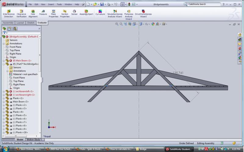

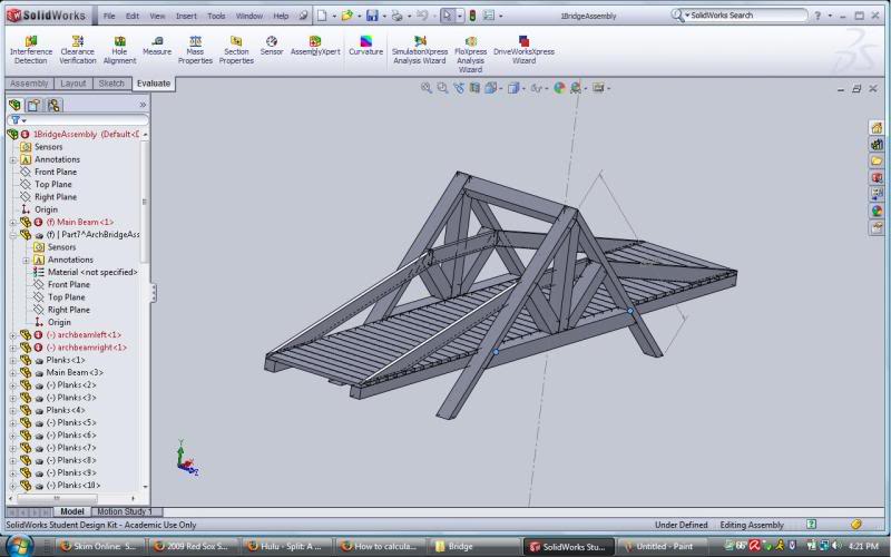

It would probably be easier for me to post an actual pic. I know that the main beams across are not necessarily the weakest points, but I just wanted to see what the max load would be if I did not have any supports. Here are two screenshots:
The main beam is split into three sections with a total of 320 inches. The middle is 120 and the end sections are 100'' each. The support beams make a right angle. The design needs to be updated since I will be using 3 4X12 beams for the main support and also the right angle support beams will be shorter.
Thanks for all the help so far.
Just to clarify, in post 11, I was referring to the hypothetical, 9144 mm beam you commented on in posts 8 and 10.
