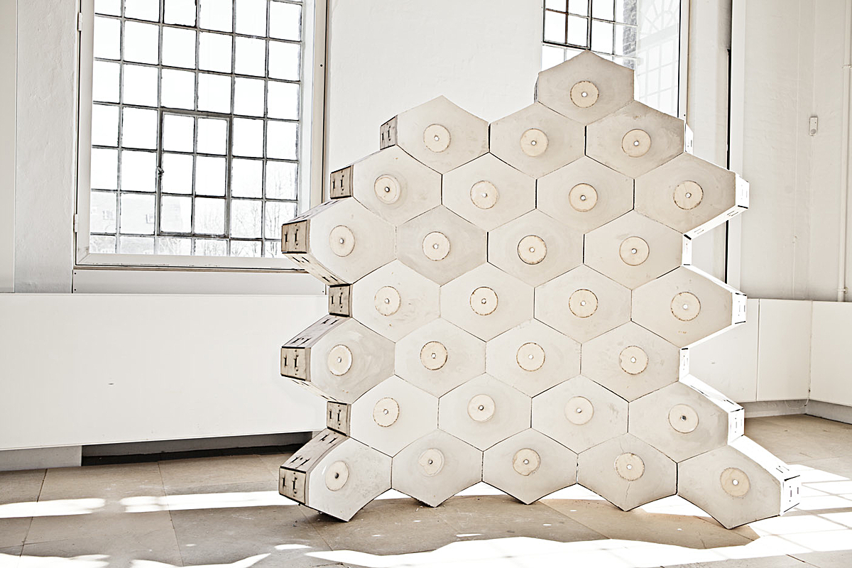

I found this lamp which is similar to what I am trying to do if this helps visualize my question at all:
http://brunofosi.com/product-design/branch-light-a-modular-led-light-system/
Here is another similar example:
http://www.plioz.com/crystal-light-by-qis-design/
And another: http://www.hyperexperience.com/?p=1026

A hexagon is a six sided planar shape.
So you envisign a flat pieces of plywood each cut into a hexagon shape, each of which would be a module, and your lamp will be made up of several of these flat hexagon shaped modules stuck together by magnets.
Is that your idea?
I'm going to use the CNC to mill these hexagonal pieces. They will have pockets in them to conceal the wires. On each of the outer sides there will be a magnet, on each of the inner sides (because the middle is cut out) there will be an LED light. My idea is that you plug the first one in and it lights up. Then you can add as many as you like in the configuration you like. And when you add a module, it lights up and the first one stays light up also. So the more you add the more light you get basically.
they will have some thickness to them
