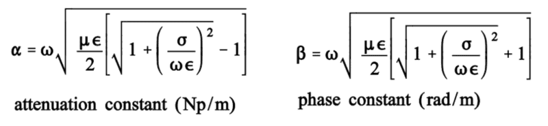

  • #64
Baluncore said:
One thing being ignored here is that due to skin effect the deeper volume of the core is not
accessible to the field, so there will be no eddy current there. Deep magnetic core is a waste of material.
I totally agree with this statement.
I found that the skin depth of the iron core used in the transformer is much smaller than I thought. Fortunately, laminations can greatly reduce eddy currents while reducing the skin effect. I think we should consider these two important factors at the same time when determining the optimal laminate thickness. I believe there should be special software to help solve this complicated problem.
Baluncore said:
It also wastes energy because magnetic field that enters thick core will be over-run by the next reverse half cycle, cancelling the earlier magnetization investment.
Sorry, I don’t understand this, please explain further or provide some reference links
Baluncore said:
The presence of inaccessible core also requires longer and thicker windings to surround more material.
This is a very undesirable situation. Of course, the most appropriate and effective method is to try to avoid the magnetic saturation of the laminations caused by the skin effect.
Baluncore said:
The thickness of the laminations is decided by skin depth, not the size of the eddy currents, nor the degree of eddy current "control" required.
When the changing magnetic field passes through the conductor, an eddy current will be generated. When the frequency increases, this eddy current will accumulate on the surface of the conductor due to the skin effect. Of course, it is very intuitive that the use of laminated sheets can reduce the negative impact of skin effect. However, if according to the reasoning method I quoted, when the skin effect is negligible, the lamination can still further reduce the influence of the eddy current.
Therefore, the thickness of the laminate will affect the adverse effects caused by the skin effect and the adverse effects caused by eddy currents, which are intertwined with each other. When the frequency increases, the proximity effect makes the situation more complicated, so I think it may not be so easy to generalize which one is the key problem to be solved. In practice, it may vary depending on the specific situation. 🤔

I think that the relationship between eddy current, skin effect, magnetic saturation and lamination thickness is indeed a complex and specialized topic. It may be that only experts engaged in this area have a more comprehensive and in-depth understanding.
I just found an article by AK Steel. There is a section titled Lamination Thickness for 50 and 60 Hz Applications, which mentions relevant information. I think it is of great reference value. I extracted part of the text as follows.

  • #70
Baluncore said:
that any core inaccessible due to skin effect, represents a real liability. That is why the lamination thickness is always calculated from skin depth in the core material
Here is where I no doubt am lacking very much for an intuitive feel for what the skin effect is all about. There is a lot, (almost too much), going on with magnetic fields getting created by the currents in the transformer windings, and getting enhanced by the magnetic material. Somehow the magnetic flux then doesn't get to the complete core, but I also don't understand how the saturation then occurs. Perhaps I am a little slow in picking up the concepts, or maybe it isn't a very easy one to learn in detail. Thank you for your patience. :)
