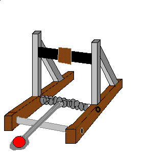

Glad to hear that. Now here's a site with some practical tips. http://www.real-world-physics-problems.com/catapult-physics.html

Glad to hear that. Now here's a site with some practical tips using twisted ropes as @Ion Aguirre suggested.
Next, using the twisted rope design, how would you adjust how far it throws?
Buggsy GC said:
wouldn't you just adjust the cross bar,
Yup. You need two calibrated positions.
I think you're on your way.

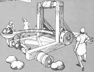

Unlike the Ballista the Mangonel does not release its energy in a linear fashion. The arm makes an arc (part of a circle) with radius equal the arm length. Therefore the Potential Energy is transferred in the Rotational Kinetic Energy. The w stands for the angular velocity and r for the length of the arm. I is the moment of inertial as the arm is a rod and its rotating on its end, I=1/3mr2
U=KErot
U=1/2kx^2=KErot=1/2Iw^2
1/2kx^2=1/2w^2(1/3mr^2)
w=sqrt(2kx^2/mr^2)
The angular velocity is then transferred into linear velocity when the arm comes to an abrupt halt and the missiles continues in the direction of their linear velocity.
does anyone the angular velocity in this example is = to w=sqrt(2kx^2/mr^2) instead of w=sqrt(kx^2/ 1/3mr^2)
retrieved from https://sites.google.com/site/physicsofcatapults/home/how-a-catapult-works-the-physics/mangonel
Also another site shows this equation = √ 3kx^2/mr^2
retrieved from:http://people.cs.ksu.edu/~nhb7817/ScratchCurriculum/Catapult/Physics Calculations for a Mangonel.pdf
