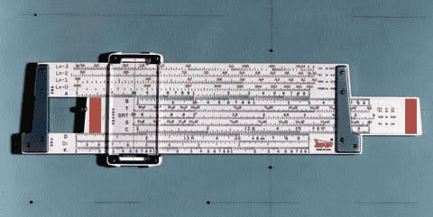

When I was a kid (early '70s) the Math teacher told us that: for a slide rule, two more digits of accuracy at the same visual scale would require a hundred times the size, whereas a calculator with two more digits of accuracy could still fit in a coat pocket.
Two significant digits is plenty for many interesting and important real world problems.
I've seen an engineering professor from the early calculator days quoted as saying that if you're looking at the second significant digit of the tensile strength... you've already made a mistake.

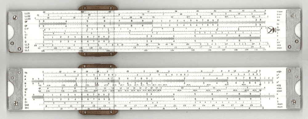

From https://www.discovermagazine.com/technology/the-first-nerd-tool:
The five-inch Keuffel & Esser Deci-Lon, the quintessential 1960s pocket slide rule, cost $12.50. Recently one sold on eBay for $180. Chemist Linus Pauling used to astound freshmen at Caltech by multiplying numbers to six decimal places on his pocket slide rule. "He calculated the last two digits in his head," says Caltech math professor emeritus Tom Apostol.
And a slide rule was present at the creation of the nuclear age—Enrico Fermi used his to calculate exactly how far a cadmium control rod should be pulled from a graphite and uranium pile as he demonstrated the first controlled nuclear chain reaction at the University of Chicago in 1942. Moments after making the final calculation, Fermi put away his slide rule, smiled broadly, and announced, "The reaction is self-sustaining."
Even with my Flying Fish log log vector slide rule, I'm still not accomplishing that much ##-## what's up with that?
