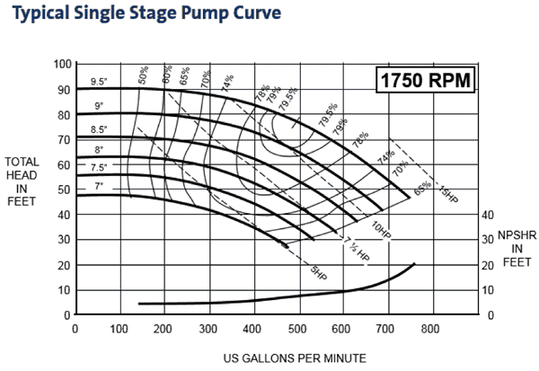

kind of, it´s head versus flow rate. From my understanding, the head or equivalent pressure is the resistance that the pump has to overcome. The lower the head (resistance), the higher the flowrate (mass flow).
here´s an example

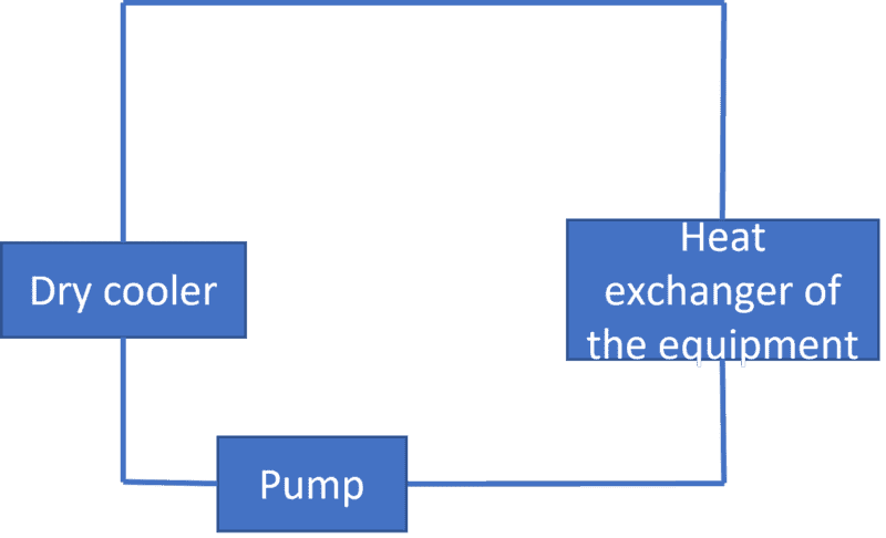

Sorry about not being clear. I would like to know if the gauge pressure is the same in every part of the system (if we can neglect dynamic pressure because the fluid velocity is about 3 ft/s). Or it depends on the part of the system where you place the pressure gauge.
Here´s a simple scheme of the system
Both dry cooler and heat exchanger are merely coils where the water pass through. So this is a completely closed system full of water.
The system is fully closed because it actually contains glycol solution (50% water, 50% glycol), which is toxic.
My another question is that if the pressure added by the pump is not compensated by the head loss, does the pump keep adding pressure even if the pressure of the fluid is already high?

If there is substantial flow, there must be a pressure differential between the two ends of the pipe system (where the pump is located).
Coils and valves are the big pressure drops that the glycol suffers in your system.
Centrifugal pumps naturally compensate for what the system demands from it.
If more pressure differential is needed (a valve is closed, for example), the flow gets reduced, and vice-verse.
The curve that the manufacturer shows for such pumps is the result of experiments where pressure differential is artificially change, only to measure how much flow results for each case.
The curve of the system (excluding the pump) shows only how the flow varies as more pressure is pushing the fluid to go through it.
An economical selection of a centrifugal pump considers both curves and try to locate the normal operation point of the system as close as possible to the point of maximum efficiency of the pump (more delivered energy into the fluid with same consumption of electricity).

I see, if the pressure is uniform, there will be no flow at all. On the other hand, I do realize that the head loss through the pipes is actually negligible compared to the pressure drop in coils and valves.
And I think I was interpreting the centrifugal pump curve wrong, the pump performance actually depends on the flow conditions and it self adapts to them, meaning that if the resistance of the closed loop system is low, the pump would just pump more flow (adding kinetic energy), it will not stick to a fixed flow and add more pressure. Until the point where a balance between the pressure drop and the differential pressure of the curve match for a certain flow rate (because the pressure drop depends on the flow rate too), then that flow rate is the system flow rate in steady state.
We are choosing a pump taking into account the friction losses only, not the total dynamic head because it´s a closed system. We have a design flow rate, we were just not sure whether the pump we have chosen would overpressure the system if the real head loss (we have estimated one) is lower than the pump´s head for that given flow rate, now we know that the pump would just pump more flow rate and we can actually modify valve openness (forgive me for using this word) to add resistance and make sure that the flow rate reduces and matches the required one.

thought i have no final guaranteed answer yet i have some insights and here they are according to my understanding,
if a closed loop is filled and closed with an X amount of static pressure then physically there is no way for any point in this closed loop to have a static pressure less than this X amount EVEN if we installed a pump and run it
for example lets say we have filled the loop with 3 bar static pressure and installed a pump and run it then then the lowest static pressure in the whole loop will be the pump suction side and this static pressure must always be 3 bar independent of the flow rate
so if equilibrium/steady state flow condition defined by the intersection between system and pump curves was at 100 m3/hr and 50 m head (5 bar approx. in case if water) then the pump discharge will be 8 bar and suction forever 3 bar and the 5 bar differential are the friction losses within the loop
if you throttle discharge valve more the flow will decrease and differential head/pressure will increase say will be 9 bar then at this case still discharge pressure will be 12 bar and suction pressure forever 3 bar and 9 bar friction losses and so on
for this reason i think there is no way according to physics to do NPSH testing for a centrifugal pump in a closed loop because there is no way to reduce static pressure at suction less than static pressure at filling the system unless you install a vacuum pump to reduce suction pressure by reducing ''the initial pressure at filling''
HOWEVER, i have seen NPHS testing before with a closed loop and a throttle valve at suction without vacuum pump and pressure is reduced which makes my doubt my physics understanding illustrated above
this is why i need your insights if someone have a clear answer to correct me if i'm wrong
my thinking is, in case my understanding is right which contradicts the physical fact with actual testing i have seen is that maybe pressure is reduced due to turbulence at suction with mean value staying the same which is the static pressure at filling and the pressure guage is recording a fake/inaccurate reading and the test itself is not accurate in this way
