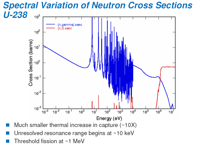

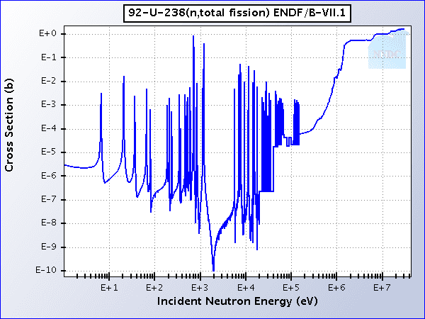

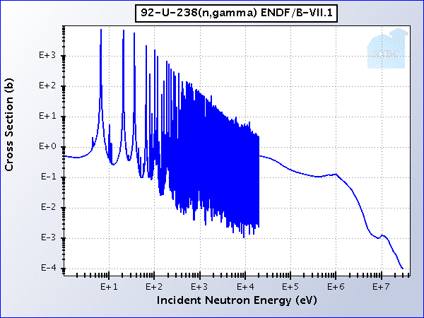

Not quite. In the neutron energy range from 0.1 to ~1.4 MeV, the capture cross-section is greater than the total fission cross-section.
Neutron energies in the 100 keV (0.1 MeV) range are considered fast.

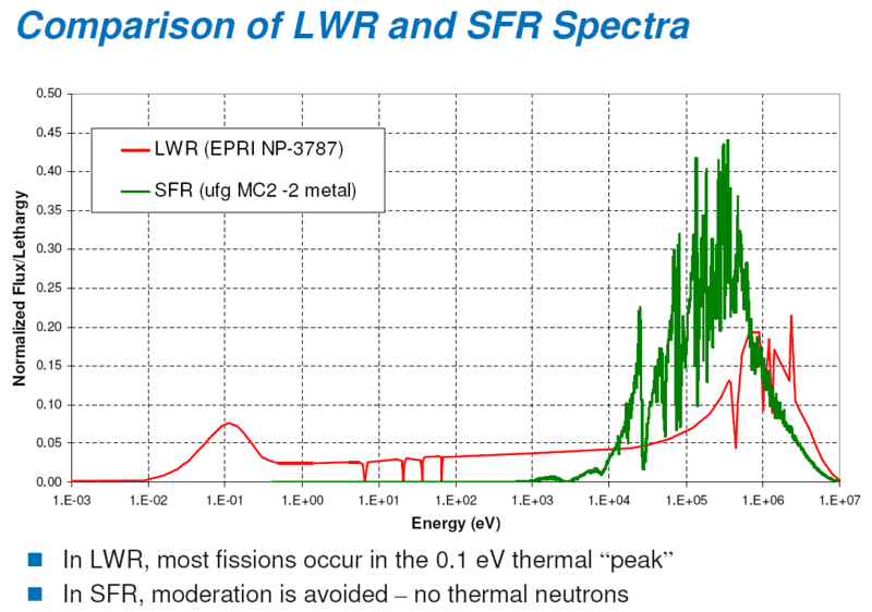

Here's a couple of figures that better illustrate U-238 the (n,γ) and (n,f) cross-sections, and the neutron energy spectrum in an LWR vs a fast reactor.
In the fast spectrum, U-238 must compete with Pu-239, the latter of which is more likely to capture a neutron and fission. After one or two collisions, fast neutrons (E > 1 MeV) drop below 1 MeV where they are more likely to be captured, rather than cause a fission, by U-238.

It is my understanding that neutrons are "born" at about 1 mev, is that so?
The graphs you posted show cross section for fission increasing in range 1-10 mev.
Some materials have a n,3n reaction in that range, hafnium for example.
Is there significant flux in that energy range before moderation?
One wonders if that's why "Bigten" works.

Yes - I'm a nuclear engineer. Most of my work is in fuel design and analysis, core materials performance, and some experience in core design.
Fission neutrons are born in the MeV range. Here is a good reference:
http://neutron.kth.se/courses/transmutation/Spectra/Spectra.html
See Figure 1: Fission neutron spectra for U-235 (red line) and Pu-239 (blue line),
and Figures 3 and 4. Note the difference in the energy weighted spectra. Part is due to oxide vs nitride, and part is due to the coolant. Nitrogen is a better moderator than oxygen, and carbon is a better moderator than nitrogen. There is a difference in n-spectrum is one uses carbide fuel as opposed to nitride or oxide. Most experience is with oxide fuel.
