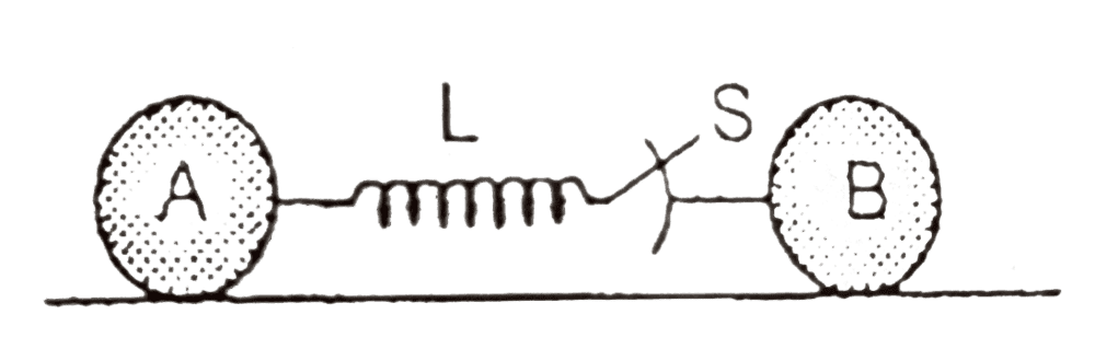

Two fixed identical metallic spheres A and B of radius R=50cm each are placed on a non-conducting plane at a very large distance from each other and they are connected by a coil of inductance L=9mH as shown in figure. One of the spheres (say A) is imparted an initial charge and the other is kept uncharged. The switch S is closed at t=0. After what minimum time t does the charge on the first sphere decrease to half of its initial value ?
Loop law: kq/r- L di/dt -kq/r=0
where L is inductance, q is initial charge on spheres.
I tried applying loop law but I am not really sure we don't really have a closed loop here.
I guess they're testing some concept here that I'm not very good at (Why do i keep coming back to mutual inductance for some reason:|)
Any help will be appreciated:)

Kirchhoff's loop rule has to do with adding up changes in potential around a closed loop (so there are actually two oddities with the 'loop law' in your relevant equations: ##\frac{kq}{r}## is a potential and not a potential difference :wink:); though I guess you could consider a closed loop to infinity and back in which case your construction is nearly correct.
Instead, suppose a current ##i## is flowing from sphere A to sphere B through the inductor, and that the charges of the spheres at any given time ##t## are ##Q_A(t)## and ##Q_B(t)##. What is the potential difference across the inductor: can you find two different ways of writing this, and equate them? How do you relate ##i## to ##Q_A(t)## and/or ##Q_B(t)##? How do you relate ##Q_A(t)## and ##Q_B(t)## to the total charge in the system, in order to eliminate one of them?
A few things to think about there...

Kirchhoff's loop rule is not going to help you here; that has to do with adding up changes in potential around a closed loop (so there are actually two problems with the 'loop law' in your relevant equations: ##\frac{kq}{r}## is a potential and not a potential difference :wink:).
So
Potential difference across the inductor is -L di/dt.
and (I'm not really sure of this-)
##Q_A(t)## should be ##Q_0## - ##i## t
##Q_B(t)## should be ##Q_0## + ##i## t
Is that right?

A few things. ##Q_A(t) = Q_0 - it## would be correct if the current were constant, however we have no grounds to assume it here. Your second equation also assumes constant current, but ##Q_B(0) = 0## in the problem statement so even if the current were constant there should be no ##Q_0##.
You're right about the PD across the inductor; that is the change in potential in the direction of the current.
Think about it like this; if sphere ##A## has a charge of ##Q_A(t)## and a radius of ##r##, what is its potential? Likewise, what is the potential of sphere ##B##? What is the potential difference from sphere A to sphere B?

Okay so if sphere ##A## has a charge of ##Q_A(t)## and a radius of ##r##, its potential should be k##Q_A(t)## /r ; likewise for B.
the potential difference between the two then becomes k##Q_A(t)## /r - k##Q_B(t)## /r .
is it okay?
Sure, so that gives you (being careful with the signs)
$$\frac{kQ_A(t)}{r} - \frac{kQ_B(t)}{r} = L\frac{di}{dt}$$ There are a few different things you could do; I would suggest eliminating either ##Q_A## or ##Q_B##, and rewriting ##\frac{di}{dt} = \frac{d}{dt}(i)## in terms of either ##Q_A## or ##Q_B## (depending on which one you have left).
Yep, solving ODE time!
