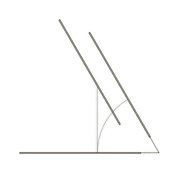

I made an image for explaining what i’m saying

I think that I understand now what the diagram is attempting to depict.
You have the original stick position on the bottom. This stick is moving upward with the left end moving faster and the right end moving more slowly. The instantaneous center of rotation is at the point where the dotted lines intersect at the lower right.
There is an arbitrarily selected point of rotation that you have chosen to place about 2/3 of the way along the stick toward the right end. This is where the middle dotted line and the circular arc intersect.
Described as rotation about this arbitrary point plus translation of the point, the stick moves upward and is depicted at its new position above. The vertical dotted line depicts the motion of the selected point.
Described as rotation about the instantaneous center of rotation, the stick rotates up and to the right and is depicted at its new position, above and to the right. The curved dotted line depicts the motion of the arbitrarily chosen point.
That drawing is incorrect.
The thing about an instantaneous center of rotation is that it is an instantaneous center of rotation. If you check again an instant later, the figure may be rotating about a new and different instantaneous center of rotation.

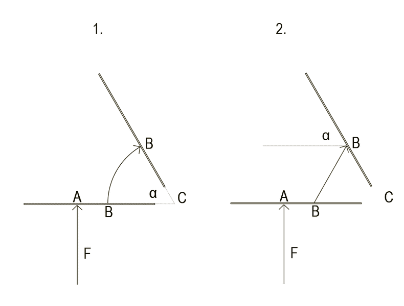

The force F is applied at point A of an object.
In the first image the force makes the object rotate around the point C by an angle α.
In the second image the force makes the object rotate around the point B by the same angle α and makes the point B translate in the same direction of the applied force.
If the linear force that cause the translation of B in the second image has the same direction of the applied force F, I don’t see how C can remain stationary.
The only way I can see it is if we consider B to be subject to a linear force with a module equal to the chord of tangential force in that point, and with a direction relative to the applied force equal to ((

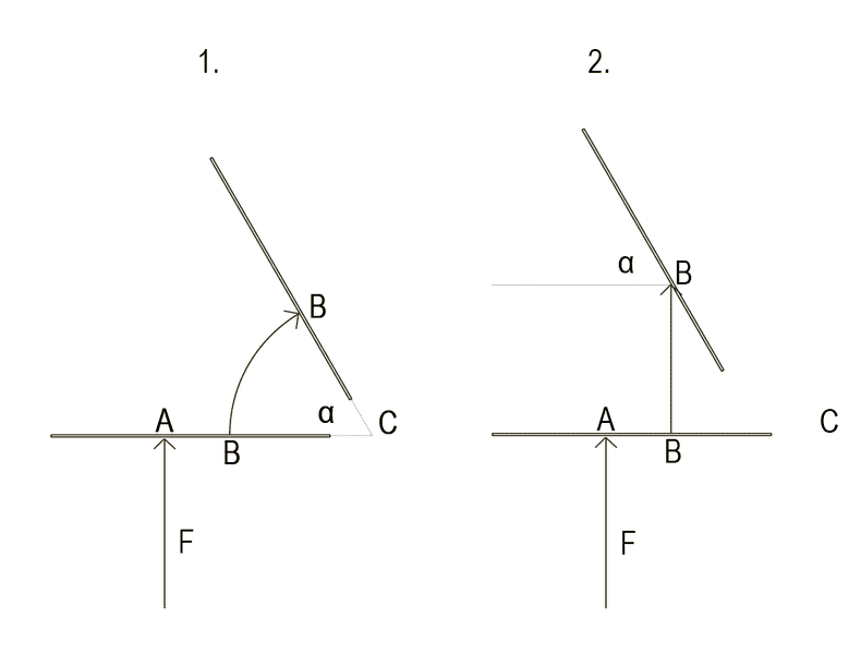

Is there a demonstration of the fact that we can describe the motion of an object during the application of a force both by the rotation around a motionless point or by the rotation around a point that is also in translation?
As I wrote previously, the point C is the instantaneous center of rotation. If any time at all passes, the center of rotation need not stay there.
The general nature of that question is interesting, but the question isn't specific.
If we make the question specific, I suspect the answer will be "No" because it can't be done.
In the first place, what is a "motionless" point? Technically, a point in a given coordinate system is a given location. It doesn't move with respect to the coordinate system.
In a given coordinate system when we talk about a "point" being in motion, we actually mean that there is some function P(t) = (x(t),y(t),z(t)) that describes a location that varies with respect to time. At a given time t0, P(t0) is a specific point. What would it mean to say that P(t) is "motionless"? Would that mean that P(t) is constant in time? - or only that P(t) has zero velocity at some time t0?
