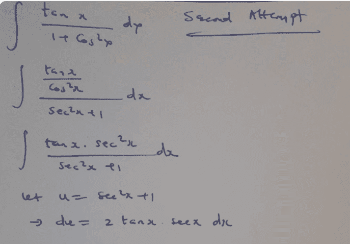

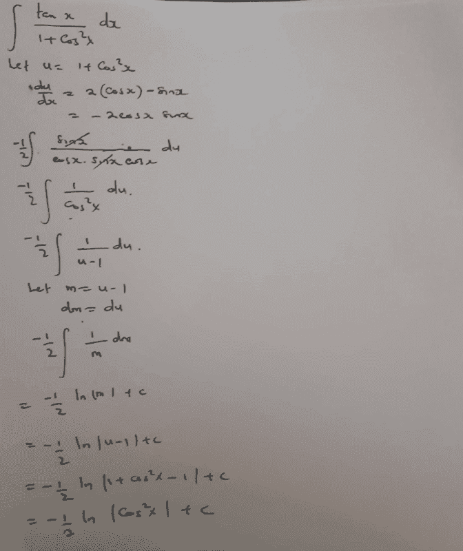

##\int\frac {tan x}{1+ cos^2x}dx##
integration
This is my first attempt ...
my second attempt...
My third attempt...bingo, I got it!
Likes Charles Link and SammyS
Your method works, but I did it with ## \tan{x}=\sin{x}/\cos{x} ##, and ## \sin{x} \, dx=-d \cos{x} ##.
With ## u=\cos{x} ##, the problem then becomes an exercise in partial fractions, and it also gets the same answer as that of the above post.

chwala said:

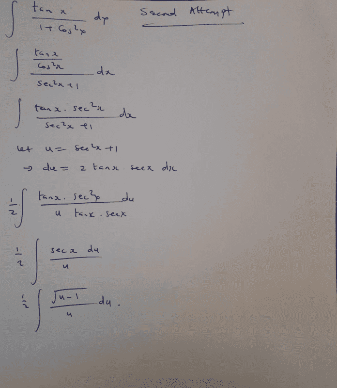

my other approach...
This works nicely, but you have an error in differentiating.
The derivative of ##\sec x ## is ##\tan x \cdot \sec x##,
so that ##du=2\tan x \cdot \sec^2 x \ dx##.
The rest of the work will follow nicely from that.
Yeah I noticed that...thanks slight error, I left out ##dx##
You also missed squaring the secant function.
I think you are looking at the wrong page, check my post number ##3##
No. My replies are referring to Post # 2.
You have the following:
But you have an error in du.
It should be ##du=2\tan x \cdot \sec^2 x \ dx ## .
Thus your integral becomes ##\displaystyle \frac 1 2 \int \frac{du}{u} ## .
Etc.
