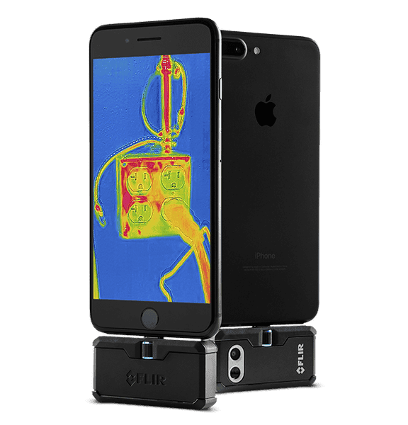

I am looking for an IR camera that can pick up 1550 nm IR light source on the pix level. I have silicon wafers and I am going to hit the pixels with a 1550 NM IR light source and I want to be able to see the pix with a IR cam. I want to connect it computer and use a C# application to view the pixels.
anyone knows a good cam I can use ?
one that is not too expensive.

What's a pix level? What do you mean by "hit the pixels" with IR? Are you going to be taking the pictures through a microscope?
What about this simple IR camera add-on for your cellphone?
Cell Phone Versions: https://www.flir.com/browse/home--outdoor/mobile-accessories/
Higher Resolution IR Cameras: https://www.flir.com/browse/home--outdoor/handheld-thermal-cameras/

when I say pix level,
I meant pixel level. so we can take a pic of a pixel.
and yes using a len to act like a microscope.

The wafer it self has pixels. I have to zoom the IR cam into one pixel on the wafer and take a picture of it.
but really i need a cam that can do 1550 NM wavelength. I look at the cam you seen, and the data sheet does not give a that information
The spec sheet for the camera he suggested does give its spectral range (8 μm - 14 μm) but it is outside your range. It is a LWIR sensor. You need a SWIR sensor. That said, you still haven't really given much information. You need to know a lot more in order to pick out an IR camera. You can find them that run from 100 USD up to 200,000 USD and work all over the IR spectrum. You really need to narrow down your search criteria here.
