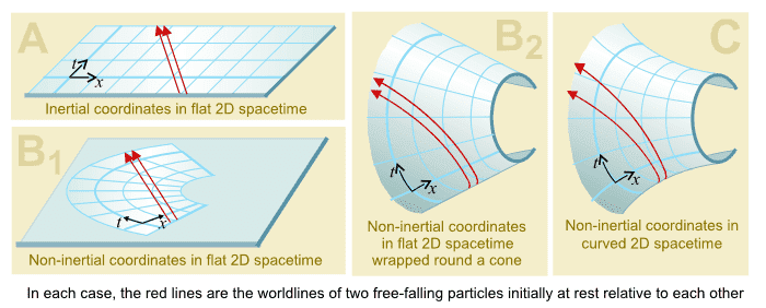

One comment that I think is worth making. "Curved" is a bit ambiguous in popular language, in the context of GR though, curvature is generally understood as meaning intrinsic curvature, such as the Gaussian curvature of a plane, see for instance https://en.wikipedia.org/wiki/Gaussian_curvature.
Einstein's elevator is *not* curved in the sense above, but is in what's called "flat" (as in not curved) "Minkowskii space-time.
Without getting too technical, we can largely equate tidal gravity with curvature. So it's common to say that Einstein's elevator has a uniform gravitational field (even though an object will weight slightly different amounts at the top and bottom of the elevator), and thus it has no tidal gravity and no curvature.
This doesn't really tell us what Gravity is - but it at least tells us what it is not. One might say that gravity, in the sense that it's used in Einstein's elevator, is mathematically represented viaa Christoffel symbols, but while this is true, I'm not sure if it helps much as a definition intended for popular audiences.
Also see this post by DrGreg for the difference between elevator frame (B) and intrinsic curvature with tidal forces (C):
DrGreg said:
This is my own non-animated way of looking at it:
  • A. Two inertial particles, at rest relative to each other, in flat spacetime (i.e. no gravity), shown with inertial coordinates. Drawn as a red distance-time graph on a flat piece of paper with blue gridlines.
  • B1. The same particles in the same flat spacetime, but shown with non-inertial coordinates. Drawn as the same distance-time graph on an identical flat piece of paper except it has different gridlines.
    B2. Take the flat piece of paper depicted in B1, cut out the grid with some scissors, and wrap it round a cone. Nothing within the intrinsic geometry of the paper has changed by doing this, so B2 shows exactly the same thing as B1, just presented in a different way, showing how the red lines could be perceived as looking "curved" against a "straight" grid.
  • C. Two free-falling particles, initially at rest relative to each other, in curved spacetime (i.e. with gravity), shown with non-inertial coordinates. This cannot be drawn to scale on a flat piece of paper; you have to draw it on a curved surface instead. Note how C looks rather similar to B2. This is the equivalence principle in action: if you zoomed in very close to B2 and C, you wouldn't notice any difference between them.
Note the diagrams above aren't entirely accurate because they are drawn with a locally-Euclidean geometry, when really they ought to be drawn with a locally-Lorentzian geometry. I've drawn it this way as an analogy to help visualise the concepts.

"B2. Take the flat piece of paper depicted in B1, cut out the grid with some scissors, and wrap it round a cone. Nothing within the intrinsic geometry of the paper has changed by doing this, so B2 shows exactly the same thing as B1, just presented in a different way, showing how the red lines could be perceived as looking "curved" against a "straight" grid."
So there actually is curvature due to proper acceleration, correct? If so, it seems to me that would mean that in the case of Einstein’s elevator, there would curvature, even if the Weyl curvature tensor would (almost) completely vanish.
