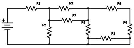

OK, here's the solution using Thevenin's theorem. First, remove R8 since it's shorted out anyway.

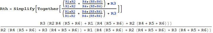

Remove R7, replace the voltage source V with a short, and calculate the equivalent resistance across the terminals where R7 was previously connected. This is just R3 in parallel with the other equivalent resistance around the loop below R3. This can all be done with simple series and parallel resistance formulas:

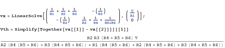

Now find the voltage across R3 using nodal analysis. The voltage source is given by V. We choose the left and right ends of R3 as our two nodes. Calculate the voltages there and take the difference to get the voltage across R3.

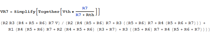

Now find the voltage across R7 using Rth and Vth in the usual way. R7 and Rth form a voltage divider so using the voltage divider formula, we get:

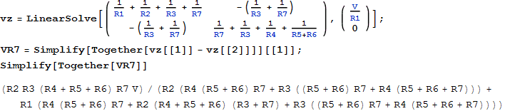

Now replace R7 in the original circuit and solve for the voltage across R7 with nodal analysis. We choose the left and right ends of R7 as our two nodes. Calculate the voltages there and take the difference to get the voltage across R7.
This is exactly the same thing we got using Thevenin's theorem.

Find the equivalent circuit for the problem below with R7 as the load below , i am sure you would opt for something else.
Draw the circuit as a 2 port network driving R7. Then, replace the two port network (not including R7) with the Thevenin Equivalent. You can thern set R7 to any value and the voltage and current will be the same in both circuits.
