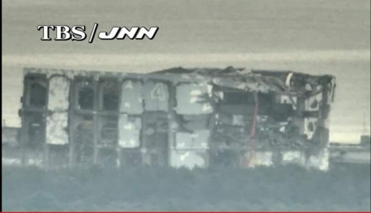

this seems to be SFP unit 4.
sorry, posted and discussed earlier! (p342)
