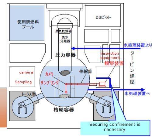

They might not have access due to radiation? they might be afraid of destabilizing the situation they are in.
I vote for some thermal imaging, I think that could be hugely relevant and possibly easier to implement? stick some form of FLIR or similar camera on a robot and drive it around and take images.
I guess the only concern in that would be losing a robot and camera at worst as I understand it might degrade in a highly radioactive environment.
honestly, I am surprised we have not seen any thermal images Aerial or otherwise from any sources, I'm sure the drones we flew over the plants some time back have this capability.also, signed up just to throw my $0.02 in on this line of reasoning, I am good at researching what interests me but highly unqualified to make any judgments :)

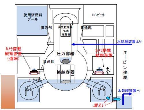

The line of thinking when cameras were mentioned was inspecting what was going on with the core, and I think closer than satellite level thermal imaging would be a great way to figure it out, and give some ideas where and what shape the core or what's left of it would be in.
on adding the camera through the water inlet:I suspect that's possible and I was just not thinking in terms of large scale length of controls. I think bore scope and 100'-200' comes to mind.

Well, there's a pipe. When they put water into it, the water ends up in the RPV. There's your access.
Is it fair to think of it as a simple pipe though? I tend to imagine it as them pumping water into existing systems, and such systems may involve far more than piping. There may be multiple points where any probe would meet something other than easy to navigate pipe, barriers to entry that it won't get round but water will.
  • #7,754
There are, for sure. Kinks and bends and valves and all that. Some borescopes are steerable just for this reason.

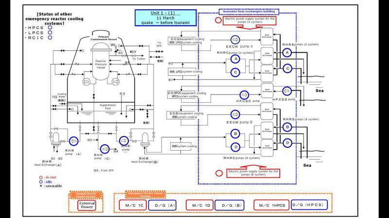

NUCENG said:
pp1,2.APRM Average Power Range Monitors 6 channels show scram at around 1446 hr...
Excellent, thanks for the detail, much appreciated. I am not going to pretend to understand every aspect of that but its great to see it explained and at least a proportion of it sinks into my mind.
So would I be right to think that, just looking at that data, things went ok in the time period covered? My presumption is that most of the data for 2 & 3 at this early period does not tell a tale of woe or of bad failures, but I wanted to learn more about what a 'normal' post-SCRAM & grid power loss event would look like, and I wanted to rule out any of the more interesting patterns on the graphs being tales of problems.
So thanks to you and the others who gave early feedback about this stuff, I will try to build upon this and get a proper understanding of these systems.
Can I ask whether you have looked at the control rod data that was released as part of this same 'data from the time of the earthquake & tsunami' bundle the other day? I could understand some of it, and again there were a couple of instances where it was showing the number -99 or the word BAD, and I wasnt sure whether this was a sign that there were problems at some stage with control rods, or whether this kind of data blip is to be expected under the circumstances, or whether I was reading it wrong. Let me find the document that I am talking about and I will post again on this subject.

radio_guy said:
I did see those from back in march, I believe from satellite and I should have clarified a bit.
I collected some thermal images here:
http://www.flickr.com/photos/26255918@N08/sets/72157626384577079/detail/
The were taken from high up, but not a satellite. It was a Japanese army helicopter. They stopped at the end of April.
Yes, these things are not too big to drive around on a small robot: http://commons.wikimedia.org/wiki/Category:NEC_Thermo_Shot
I am trying to catch up. What is the link? All I looked at so far was the unit 2 data you posted a link for.
OK the link to the japanese page which links to all the pdf's is this one, I haven't noticed whether its available in english yet:
http://www.tepco.co.jp/nu/fukushima-np/index10-j.html
Some of it is presented in an infuriating way, and some of the files are rather large.
Section 3 has documents which relate to control rods and some other stuff mixed in.
For example this is the file for reactor 1:
http://www.tepco.co.jp/nu/fukushima-np/plant-data/f1_3_Keihou1.pdf
It starts with a lot of printed logs that get very busy when the earthquake hits. Later in the document there are some tables of data that are presented in an annoying way. Finally after many pages the control rod-related data starts, and is presented in several different ways. The report formats varies considerably between reactors, some have more japanese than others, and some reactors have more snazzy visualisations of the control rod positions and what looks like other important reactor core data. Lots of the data is repetitive as it covers the normal operating hours before earthquake.
In any case, I presume that nothing bad happened to control rods, but as there are a few glitches in the data at certain moments in time, Id love someone knowledgeable to review this. For example with reactor 1 data there is a bunch of numbers but at one brief point the word BAD features. Also what looks like a 15:00 visualisation of the rods all showing the -99 value. The -99 one is on nearly the last page of the document, and is somewhat obscured by being printed in the same place on the same page as another type of data. I expect its nothing/normal but I just want to be more certain.

Thank you. I will give it a shot. My Japanese is abot 40 years old. I am even afraid to try it in a sushi house because I am afraid of insulting the sushi chef. Wouldn't want to get some bad fugu.
  • #7,768
Well I was quite surprised how much of these documents meant at least a bit to someone like me who has no japanese or special technical reactor knowledge, so I think you'll be ok :)
As mentioned before the main problem with all this data is that it ends too early to see the vivid details of things going wrong. I can only imagine what a nightmare it was for those trying to deal with all the reactors to be in the dark, data-wise, for much of this period as well.
