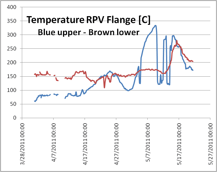

NUCENG said:
You may be assuming a complete failure of the vessel bottom which may not have happened. The instrument and CRDM penetrations of the vessel are more likely to have failed first allowing corium to exit the vessel. The thermocouples in US plants are qualified to at least 2300 degrees F per USNRC Regulatory Guide 1.97.
According to GE they are actually a Type T Thermocouples with a 350C upper limit. They are magnetically attached which is another big problem. Does anyone know of a magnet that still works when heated over 1000C? Only the thermocouples on the RPV head are attached mechanically.
[PLAIN]http://img89.imageshack.us/img89/7498/thermo.jpg
[PLAIN]http://img89.imageshack.us/img89/7498/thermo.jpg[/QUOTE]
My bad, thermocouples were dropped for RG 1.97 per
http://pbadupws.nrc.gov/docs/ML1109/ML11098A049.pdf
You are correct about type T range. Thanks for the correction.
What document is that from?
There is a lot that is unknown about thermal properties during a core melt event.
http://www.tec-sim.de/images/stories/lecturenotes-late-in-vessel-phenomena.pdf
On page 16 of that document:
Though in the TMI-2 accident no external cooling was available, the vessel wall did not experience any noteworthy thermal attack in contradiction to what all simulations predict to date. The thermal attack on the vessel wall was limited to a hot spot in which the internal vessel wall reached temperatures of ~1100°C in a region of approximately 0.5 meter width, which was rapidly cooled after approximately 1/2 hour.
There is the distinct possibility that molten material relocated out of the RPV without necessarily requiring the entire bottom head to fail. There's also the possibility that such a magnetically attached thermocouple became "no longer attached" to the vessel at some point.
Cobalt would be a Candidate (T_c ~ 1400K). This is the material with the highest Curie temperature I know of.
