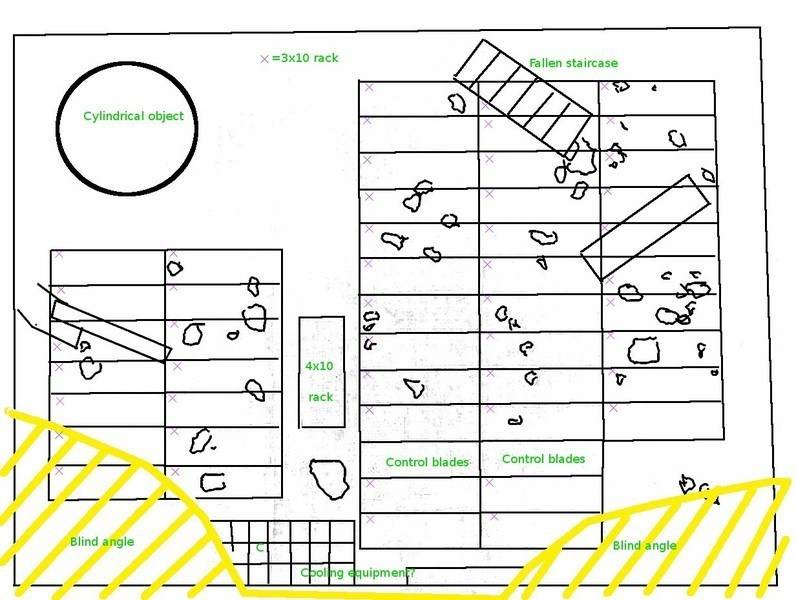

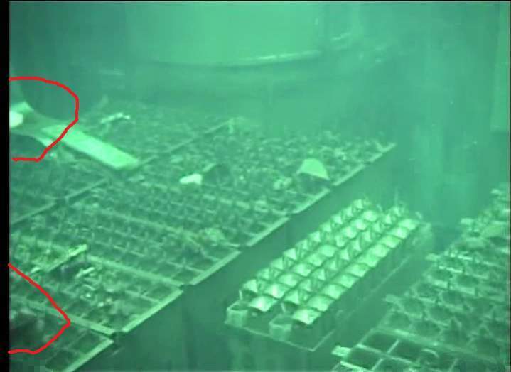

  • #12,683
Comparing the same position in the SFP of Unit 4 in an early, and in the most recent video, there's been some change:
It appears some assemblies are 'passive' and have simply developed a uniform caking on their tops, obscuring the view to any detail below, The assemblies seen in the montage above are of that type. Other assemblies are to a differing degree 'active', and have been popping/cracking the caking developed on their tops, particular so over their (empty) center tubes.
The caking has a somewhat tainted surface, but it seems in the main to be composed of a whitish mineral substance. I wonder, what it could be. Would someone with nuclear knowledge know if there could be a presence of objects made of aluminium alloy in a BWR spent fuel pool?

  • #12,685
That caking in SFP4 kinda' worries me. Without water circulation, sufficient heat buildup could cause a geyser.
Months ago I posted a theory that a large geyser was responsible for the building 4 explosion. There'd certainly be enough energy in the pool to destroy the building, if circulation of water were largely blocked.
Given that the radiation distribution in the vent filters shows that gas was injected into building 4 through the vent, I'm assuming that this was a source of hydrogen and that the explosion was in fact a hydrogen explosion and not a steam explosion.
But I'm still concerned about future geysers in SFP4. Are any countermeasures being taken?

Be careful with those photos, the perspective is tricky, and that stack is HUGE.
I've attached a picture where I marked the supposed location of the gamma camera. The person with the stick is on the other side of the stack, the gamma cam can't see him or the position he pokes with that stick. Actually, we have no real picture about that source on the bottom of the stack which the gamma cam see.
The other source high in the air can be both on the small or the big pipe (I've underlined the small with green and 'overlined' the big with blue), but the position is clearly outside the base area of the stack tower.
So the small 'drip' will be outside that area too. And we have no real picture about that area too.
