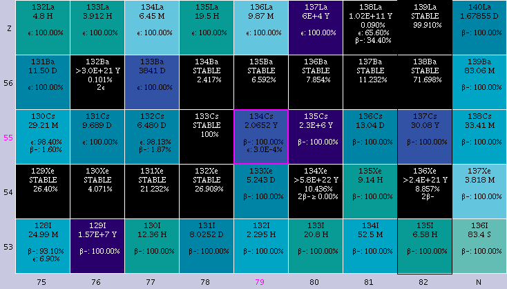

Given the isotopes already found and their ratios, should we expect to be finding Sr-90 in the contaminated water/soil/air?
Aside from sharing the dubious distinction of both nations having been at the receiving end of America 's nuclear weapons, Japan and the Marshall Islands now share a second dubious distinction. The unleashed isotopes of concern from the damaged Japanese reactors - Iodine-131, Cesium-137 , Strontium-90 and Plutonium-239 - are well known to the Marshall Islanders living downwind of the testing sites at Bikini and Enewetak atolls in the central Pacific, following sixty-seven A- and H-bombs exploded between 1946-58. In fact, it is precisely these isotopes that continue to haunt the 80,000 Marshallese fifty-three years after the last thermonuclear test in the megaton range shook their pristine coral atolls and contaminated their fragile marine ecosystems. • Strontium-90 has a half life of twenty-eight years, is a chemical analog of calcium and is known as a "bone seeker"; Rongelap and the other downwind atolls have residual Sr-90 in their soils, groundwater and marine ecosystems. http://www.countercurrents.org/alcalay270311.htm
