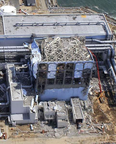

Could this be melted spent fuel 2 flowing out of 1 in this pic of Reactor #4 ?
and defy gravity?
Boy, once you plant the thought in my mind, it does look like melted lead flowing over the debris.
