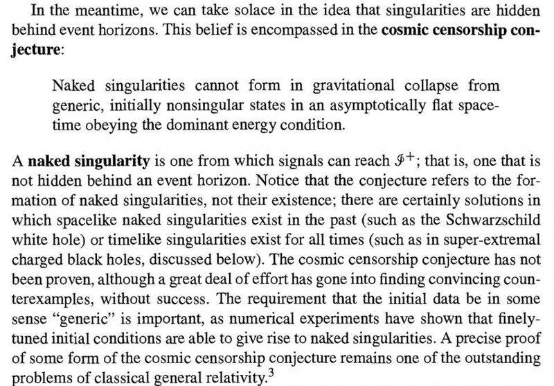

According to Cosmic Sensorship Conjecture, naked singularities are prohibited in General Relativity. To my knowledge, naked singularity means light from the singularity can escape to infinity.

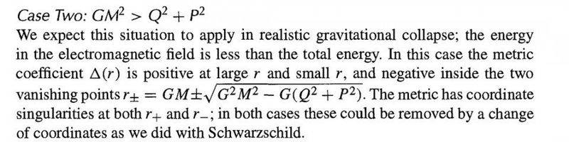

In Reissner-Nordström metric, references say naked singularity appears only if ##GM^2<P^2+Q^2##. However in ##GM^2>P^2+Q^2## case, according to the Penrose diagram below, light from the singularity which is a timelike surface can take a path which leads to the New Universe.

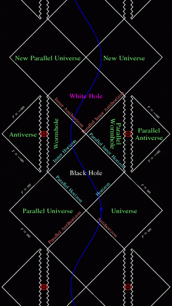

Does it mean, an observer can see the singularity while he/she is in the wormhole, white hole and in the new universe? Isn't it considered as a naked singularity?
This is correct. But from the standpoint of the new universe, the light from the singularity is coming out of the white hole. That means nobody in the new universe can reach the singularity, even with a light signal, because they can't go into the white hole. And that means the singularity isn't a naked singularity, because for a naked singularity, observers in the same universe have to be able to both see light from the singularity and send light signals to the singularity.

Elnur Hajiyev said:
an observer in the wormhole part of the spacetime can both send and receive light from the singularity, right?
Yes, but that part of the spacetime does not include infinity.
Elnur Hajiyev said:
If I get it correctly, it will not be considered as a naked singularity, will it be, because wormhole is a limited zone of the diagram, enclosed with horizons.
Yes.

Wikipedia is not a good source to begin with. In GR textbooks the term "naked singularity" is not defined explicitly at all, as far as I can see; for example, in Carroll's online lecture notes on GR, in Chapter 7, the term is used without ever being defined. So the only definition we have is implicit, by looking at the context, at which cases are described as having a naked singularity and which are not. Since the geometry with ##GM^2 > P^2 + Q^2## is always described as not having a naked singularity, there must obviously be a condition of the sort I have described in the (implicit) definition that is being used.
@PeterDonis , I study from S. Carroll's book and it is from there, that's why I am confused.
Ok, this might be a somewhat different definition than the one I was using. Note that here he says that the conjecture refers to the formation of naked singularities, not to their existence. In the quote he explicitly says that the Schwarzschild white hole singularity is a naked singularity. He also says that the super-extremal charged black hole (i.e., the case ##GM^2 < P^2 + Q^2##) singularity is. He does not explicitly say that the singularity in the sub-extremal charged black hole (where ##GM^2 > P^2 + Q^2##) is a naked singularity, but the analogy with the Schwarzschild white hole would suggest that it is. So it might be that the textbooks are not entirely clear or consistent about the definition.
There is also another important point made in this quote: note that it says the cosmic censorship conjecture is about the formation of naked singularities, not their existence. In other words, singularities like the Schwarzschild white hole or the super-extremal charged black hole singularities exist in mathematical solutions, but they are not physically realistic because there is no way for them to form in the first place. Similar remarks would apply to the singularity in the sub-extremal charged black hole.

Elnur Hajiyev said:
the white hole which opens to another spacetime
This is not correct. All of the different "universes" are part of the same spacetime.

But sub-extremal RN black hole can be formed from generic initial conditions and there will be singularity behind the inner horizon. This singularity still cannot be seen from the vicinity of the black hole, that is why it is not considered as a naked singularity from the perspective of spacetime, where the black hole is formed. On the other hand, the singularity will be seen from the different patch, so it will be considered as a naked singularity in the vicinity of the white hole.
No, it can't. The interior of this solution (everything inside the outer horizon) is unstable against small perturbations. (In fact this is true of all the idealized black hole solutions, including Schwarzschild). "Generic initial conditions" requires stability against small perturbations.
Elnur Hajiyev said:
I think it is not important in this situation, whether the second patch is of a different or the same one
It doesn't matter. They are connected through the "wormhole" regions, so they're part of the same spacetime.
Elnur Hajiyev said:
the metric does not imply anything about the connection of the patches
Yes, it does; they are connected through the "wormhole" interior. See above.

I would really like to see the references from which you come to these conclusions.
The fact that the interiors of the idealized black holes are unstable against small perturbations is common knowledge at the graduate level in GR; since this thread is an "A" level thread, that background knowledge is assumed. IIRC it is discussed in MTW and Wald.
Elnur Hajiyev said:
Can you please show which part of the metric implies mathematically that the infinite spacetime patches should belong to the same universe?
I didn't say they "belong to the same universe" (by which I assume you mean the infinities in each of them are the same infinity). I said they are all part of the same spacetime, because they are connected through the "wormhole" interior regions. That is obvious from the diagram in the OP of this thread, and it's true regardless of the relationship of the infinities in each exterior region to each other.
By saying different spacetime, I meant different spacetime patches with different infinities. I assumed that you meant the same.
Elnur Hajiyev said:
You said sub-extremal black hole cannot be formed from generic initial conditions. I showed you a reference from S. Carroll's book in which it says it can
I don't see such a statement in any of the references you have given. If you are referring to the quote you gave in post #12, it does not say that. It says that a "realistic gravitational collapse" should obey the sub-extremal condition ##GM^2 > P^2 + Q^2##, but it does not say such a collapse will form a sub-extremal black hole with the singularities inside the "wormhole" region from generic initial conditions.
You assumed incorrectly. "Spacetime" is standardly used to refer to an entire connected manifold. Everything shown in the diagram in your OP, including the multiple exterior patches with different infinities, is all one spacetime according to the standard usage of that term. Again, this is an "A" level thread so that kind of background knowledge is assumed. The word "patch" is used to refer to a portion of a spacetime; it is not a synonym for "spacetime".

Elnur Hajiyev said:
I wrote that naked sigularity is naked from white hole infinity and is hidden from black hole infinity
Yes, and after consideration, I agreed with you; the way the term "naked singularity" appears to be used by Carroll, it implies that a white hole singularity is naked and a black hole singularity is not.
Elnur Hajiyev said:
Black hole infinity does have horizon, from which "light cannot escape", so I am convinced CSC is not violated. You say it is not for that reason.
No, I said that the white hole singularity being naked does not violate CSC. That is because the white hole singularity cannot form from generic initial conditions, so the precondition for CSC to apply at all is not met. It has nothing to do with the exterior region that the white hole emits light signals into "not being part of the same spacetime", which is what you claimed the reason was.
