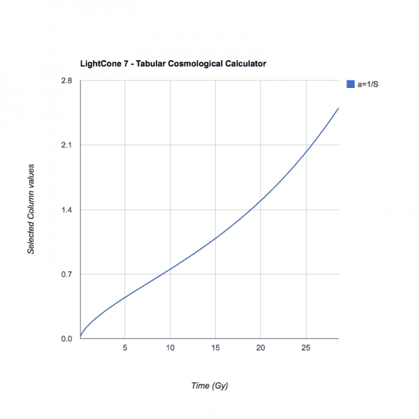

We can get Lightcone to plot the curve of the scale factor curve a(t) (which is proportional to the growing size of the distance so has the same shape). It will have an inflection point about halfway between 5 Gly and 10 Gly---that is about where 7.6 is.

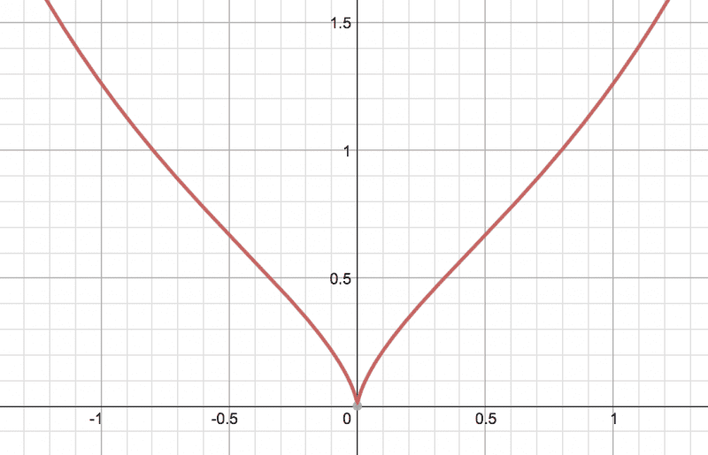

Another version of essentially the same scale factor a(t) curve---just look at the right half which is the expanding part, not the contracting mirror image.
this is where you use a different time scale on the x-axis. But the same y-axis. the scale is you use a time unit of 17.3 billion years. So the present (13.8 billion) comes out to be 0.8
and the scale factor is normalized to equal 1 at present, so you can see a(now) = a(0.8) = 1
The inflection point comes about halfway between 0.4 and 0.5 on the x axis. that is where year 7.6 billion is, on this time scale.
the curve is basically a hyperbolic trig function that happens to match the way the universe grows, the history of how distances have increased.

Thank you Marcus. The thing I don't get is that even at their minimum value, those velocities are very close to c. How would I reproduce the case of a Galaxy in the Coma Cluster for example. For a distance of roughly 300 Mpc they would produce a recession velocity of under 30000 km/s and I haven't been able to simulate that in the calculator.
All the growth history curves, for other distances, look the same as the one in the figure. they are just scaled proportionally.
The curve which Lightcone can make is for the distance which equals 14.4 Gly at the present (S=1)
If you want the distance history curve for a distance that is 1/10 that size, like 1.44 Gly at the present, you just have to divide all the distances in the sample by 10. and divide all the SPEEDS by 10.
when you scale a curve down, it scales the slopes down in the same proportion.
