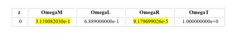

I think if at input Ωm,0 = 0.3111 but at output it becomes Ωm,0 = 0.3110082030, it is a discrepancy.
You are right, but to output OmegaT,0 >1 would also be a discrepancy, because without giving the value explicitly, the collaboration the spatial flatness in words, if I read the paper correctly.
So maybe we miss something in the equations, but as a non-cosmologist, I can't figure out what.
But I think the alternative which is to have an input of Ω0 = 1 become an output of Ω0 = 0.9999101295 is worse: non-zero curvature is "a big thing" and is something that should be explicitly input, not extracted out of what is more or less rounding errors.

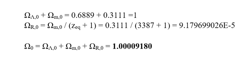

Let’s use PLANCK(2018+BAO) as an example for the following discussion (see Post #25):
If we insist to have,
we are forced to have,
So, Ω0 cannot be 1 in this case.
If we set ‘Total density parameter, Ω’ in LightCone8.1.2 - Jorrie to be 1.000091824, the discrepancy is eliminated:
To summarize:
We cannot insist that ΩΛ,0 + Ωm,0 =1 as is done in Planck 2018 results. I and still have Ω0 = 1.​

This is not correct. Planck 2018+BAO gives us ## \Omega_{m,0} = 0.3111 \pm 0.0056; \Omega_{\Lambda,0} = 0.6889 \pm 0.0056 ##. Now we can argue about the independence of those errors, but they certainly don't give us ## \Omega_{m,0} + \Omega_{\Lambda,0} = 1.00000 000 \pm 0.00000 000 ##. Adjusting ## \Omega_{m,0} ## to 0.311008176 to accommodate ## \Omega_{rad,0} ## is still within ## 0.02 \sigma ## of the survey result!
Let's look at the values at ## t = t_0 ##as they are now with Planck 2018+BAO selected, and with ## \Omega_{m,0} ## forced to 0.3111
ParameterPlanck 2018+BAOLightCone8 defaultForced ## \Omega_{m,0} ##
## \Omega_{\Lambda,0} ##0.6889±0.00560.68890000000.6889000000
## \Omega_{m,0} ##0.3111±0.00560.31100820300.3111000000
## \Omega_{rad,0} ##~9.180e-50.000091796990260.00009182408501
## \Omega_{0} ##"Consistent with 1"1.0000000001.000091824
## \Omega_{\kappa,0} ##"Consistent with 0"0.0000000000.00009182408501
Age13.787±0.020 Gyr13.78704250 Gyr13.78629120 Gyr
Now OK, it doesn't make a huge amount of difference (except to curvature itself of course), but LightCone8 as it is gets the age of the Universe bang in the middle of the Planck 2018+BAO result whereas if you allow positive curvature it is 1 out in the 5th significant figure. This is not the point though, the Planck 2018 results are fitted with the assumption of flatness so it is inconsistent to use the numbers to say there is curvature.

I think LightCone8 is working properly. We can use it to verify the following table:
It suggests we cannot insist that ΩΛ,0 + Ωm,0 =1 and still have Ω0 = 1 and Ωk = 0.
We may be able to use statistical argument to say that Ω0 is approximately equal to 1 for a particular observation data, but it is not.

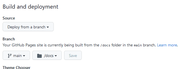

Yes, that the trail becomes the "official model", provided that we agree that we should input these 5 parameters, all givens by the Planck collaboration.
Our model implementation then forces ##\Omega## to be whatever this input is (default 1, but we are allowed to change this for educational purposes).(a) This is done by subtracting ##\Omega_R## from ##\Omega_M##.
Or we can decide to go more sophisticated by using a statistical method, based on the given error bars on all the inputs. My suggestion is that the "trail version" is good enough for now.
Footnote (a). When we started the original project, the then-core members were keen to keep options open so that hypothetical open and closed models could be demonstrated. Plus of course to be ready for potential future observation favoring a universe that is not spatially flat.

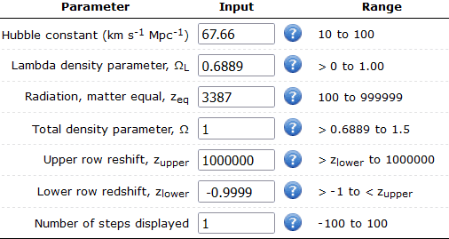

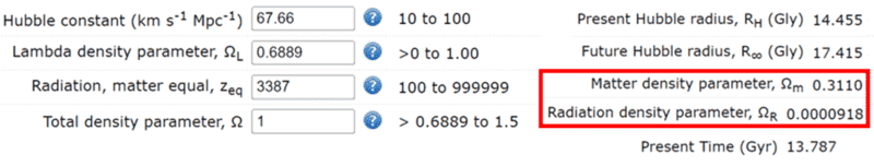

Ok, I have made the changes discussed above in the UI. Must still update Tutorial to explain.
An important change to take note of, is that I have reduced the mapping value of ##\Omega_{\Lambda,0}## input by 0.0001 in order to accommodate radiation density into flat space and remove any ambiguity in the UI or output data. So for now there is nothing extra to be done in the expansion calculation module.
The Planck collaboration says above Table 2: "The top group of six rows are the base parameters, which are sampled in the MCMC analysis with flat priors. The middle group lists derived parameters." ##\Omega_{\Lambda,0}## does not appear in the top group, but baryons and dark matter do. Hence I took it that ##\Omega_{m,0}## takes priority and so I changed ##\Omega_{\Lambda,0}## by the mentioned small amount.
@pbuk and @JimJCW. Comments?

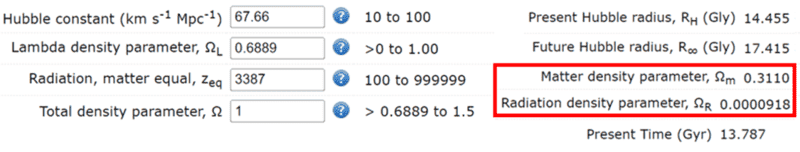

Among Ω0, ΩΛ,0, Ωm,0, ΩR,0 and zeq, only three of them can be used as inputs because of the following two relations:
LightCone8 (https://burtjordaan.github.io/light-cone-calc.github.io/) correctly uses only three: Ω0, ΩΛ,0, and zeq, but LightCone8.1.2 - Jorrie Trial UI (https://light-cone-calc.github.io/) incorrectly uses four: Ω0, ΩΛ,0, Ωm,0, and zeq. This causes the discrepancy in LightCone8.1.2 (see Post #30, #40, and #42).
I noticed that in LightCone8.1.2 the inputted Ωm,0 is used only in calculating ΩR,0 printed to the right. The rest of the calculations is the same as LightCone8, using only Ω0, ΩΛ,0, and zeq. Let me illustrate this using an exaggerated example (setting Ωm,0 = 0.9):
The output remains the same as in LightCone8:
So, using both ΩΛ,0 and Ωm,0 as inputs at the same time is incorrect and produces discrepancies.
Suggestion:
We can use Ωm,0 and ΩR,0 as derived quantities and print them on the right-hand side:

Oops, yes thanks for the headsup - I see now that the table calculation module ignores the matter density input value. I will temporarily reset the old input tables. But I would still like to use Ωm,0 as one of the primary inputs (for reasons that I mentioned in my prior post). So it would mean swapping ΩL and Ωm in what you have above.
To do the change in primary input, @pbuk must also alter his calculation module to use Ωm,0 as primary input. I will coordinate with him to get us there.

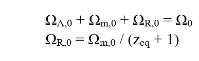

Please see Post #13:
If Ωm,0 is used as input (see Post #2, where seq = zeq + 1),
ΩΛ,0 = Ω0 - Ωm,0 (zeq + 2) / (zeq + 1)
ΩR,0 = Ωm,0 / (zeq + 1)
@pbuk

JimJCW said:
The source of our problem is that Planck 2018 results. I data is incorrect for a flat universe:
We shouldn’t use these numbers as given at the same time.
Yea, you are right. Trying to use all 4 will give inconsistencies.
For now, let's leave it as it is.

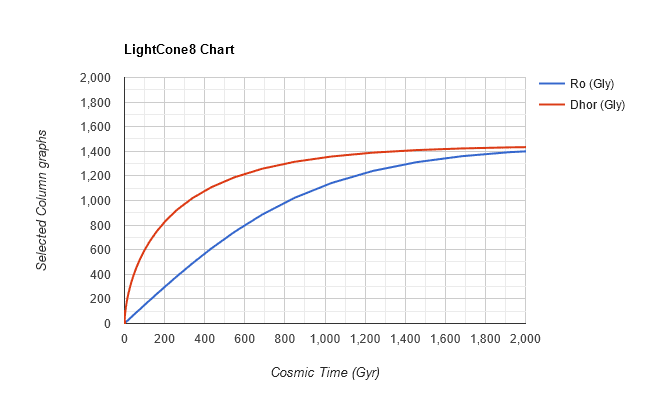

  • #59

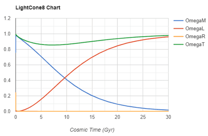

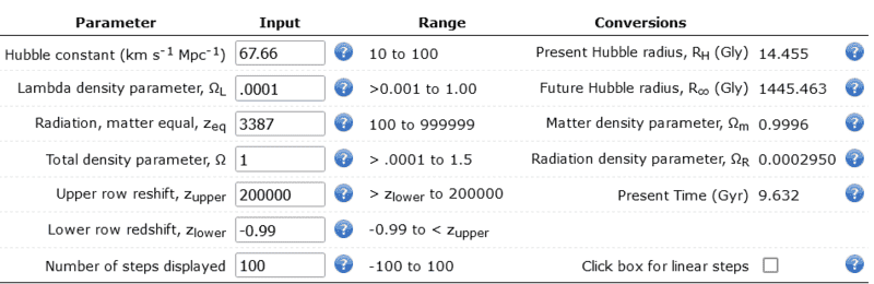

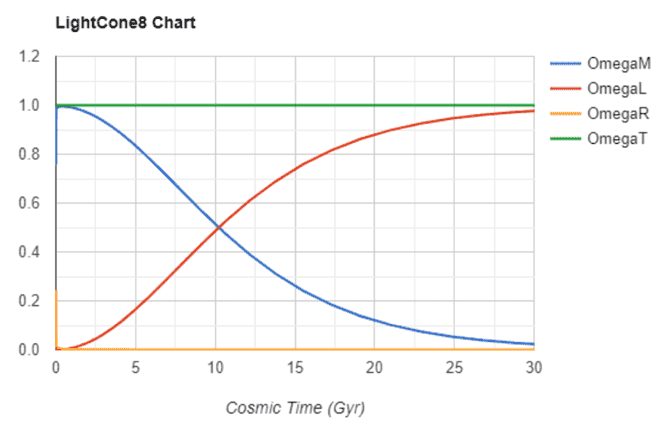

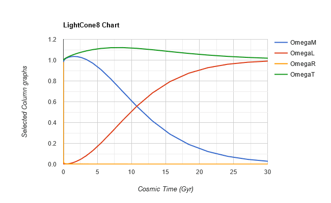

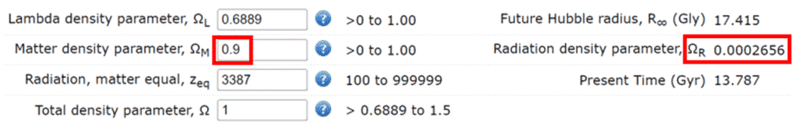

If we ever find Omega_0 slightly above 1, the most likely culprit will be dark matter. Here is a graph for Omega_0 = 1.1 (an exaggerated case for visibility)
Interesting how Omega will first rise (in this case overshooting the the "current 1.1" slightly) and then being dragged down to unity again by dark energy dominance.
  • #60
The expansion of space in the Big Bang model makes many situations very complicated. I often use the LightCone calculator to help me to get pictures in my mind. The following two pictures are similar to yours:
For Ω0 = 1:
For Ω0 = 0.9:
  • #61
Cool! - it looks like we've got ourselves a workable calculator. :smile:
I have just pushed a small update that shows ##\Omega_M## and ##\Omega_R## on the conversion side, as discussed before.

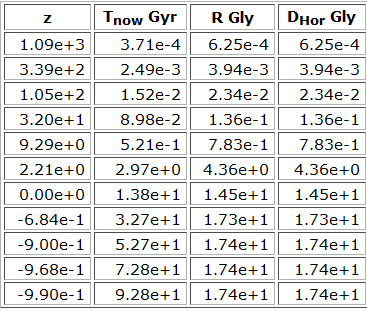

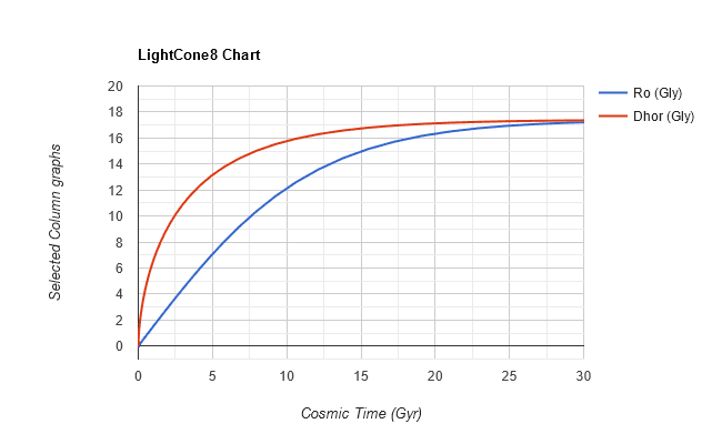

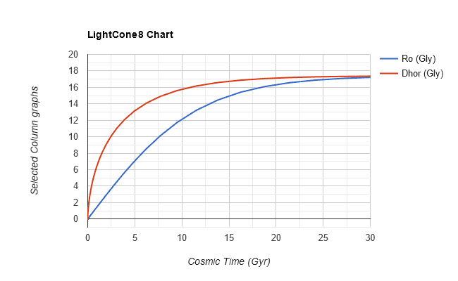

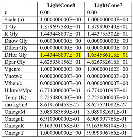

Discrepancy between LightCone8 and LightCone7:
When comparing the outputs of LightCone8 and LightCone7, I noticed a discrepancy in calculated event horizon:
I think the value calculated with LightCone8 is questionable.
@Jorrie, @pbuk
  • #63
It seems to be exactly the same as R, I'll have a look tonight (UK).
Interesting, I had started with the code from the last version of LightCone7 http://jorrie.epizy.com/lightcone7/2022-05-14/LightCone7.html and it gives exactly the same incorrect results. But when I use an older version of LightCone7 e.g. http://jorrie.epizy.com/Lightcone7-2021-03-12/LightCone_Ho7.html I get the expected results.

  • #68
Yes, correct. Is it something that you can fix on the calculate side, or must I fix it outside of calculate?
  • #69

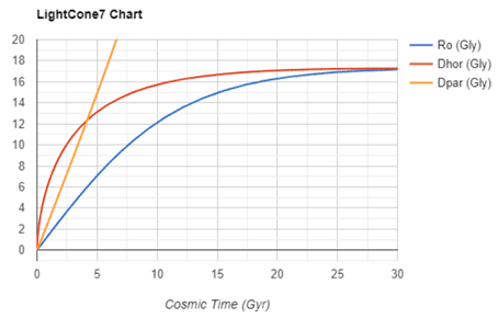

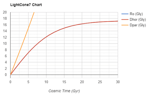

Let’s call
A: http://jorrie.epizy.com/Lightcone7-2021-03-12/LightCone_Ho7.html
B: http://jorrie.epizy.com/lightcone7/2022-05-14/LightCone7.html
and use PLANCK Data (2015) for the present discussion.

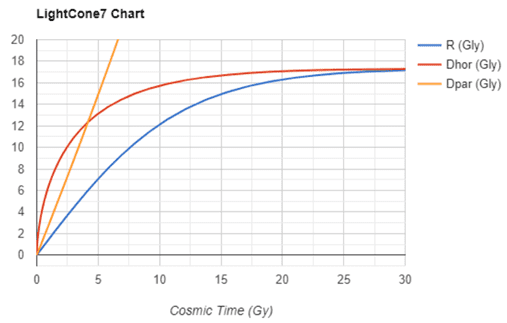

Result from A:
Result from B:
Note that Ro and Dhor overlap with each other.Comparing the Calculation.js files of A and B, I noticed that some statements in A are not in B: near Line 180 and Line 245. If we put the missing statements back to B:
pa = a_ic * sf;
////////////////*************Add the following missing line
a = a_ic + (pa / 2);
////////////////*************Found the problem
qa = Math.sqrt((Om / a) + Ok + (Or / (a * a)) + (Ol * a * a));
Dthen = 0;
////////////////*************Add the following missing lines
else
Dnow = Math.abs(Dtc-Dc);
Dthen = a * Dnow;
Dhor = a * (Dte-Dc);
Dpar = a * Dc;
the modified B gives the following result:
@Jorrie
  • #70
Fixed now. I've also tidied up the html (there were some extra empty <td>s and unmatched </tr>s) and bumped the version to 8.3 for the added CSV functionality.
I've pulled all these changes into the 'main' branch and changed the source for the live site back to 'main' from 'develop' for good practice.
61
