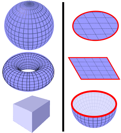

I mean, I'm thinking about a spinning coil (close surface) in a magnetic field. When the angle changes the number of field lines that pass through the coil changes, so the magnetic flux should change too. But since every line that enters the coil exits it, then the flux is always zero... so it's like there are less( or more depending on the angle variation) lines through the coil, but at the end the magnetic flux is always zero, then its variation should be equal to zero too
No, when we say flux 'enters' or 'leaves' a "surface", it's implied that we're dealing with a closed surface enclosing some (3-dimensional) volume. Then, convention dictates the normal vector to the surface points outward, so if the magnetic field points out of the surface at some point on the boundary that counts as positive flux, and vice versa.
If you just have a circular ring, then it's easiest to consider a flat open surface with a bounding curve along the ring. If the magnetic field is constant in the vicinity of the ring, then the flux is just$$\Phi_B = \boldsymbol{B} \cdot A\boldsymbol{n} = BA\cos{\theta}$$where ##\boldsymbol{n}## is a unit normal to the surface. Clearly, this will be non-zero so long as ##\boldsymbol{B}## is non-zero and not orthogonal to ##\boldsymbol{n}##. For an open surface, there's no useful notion of 'entering' or 'leaving' the surface, not least because there's no a priori preferred direction for ##\boldsymbol{n}##.
etotheipi said:
No, when we say flux 'enters' or 'leaves' a "surface" (we should, really, say "region"), it's implied that we're dealing with a closed surface enclosing some (3-dimensional) volume. Then, convention dictates the normal vector to the surface points outward, so if the magnetic field points out of the surface at some point on the boundary that counts as positive flux, and vice versa.
Thank you, now I've got it! I didn't understand the difference between close and open surface. I thought an open surface was a surface without boundaries and that a flat circle without volume was a close surface. Now it's clear. Again I'm very glad you've helped me to understand
Ah, yes as you noticed, that's not right. Skirting around a few mathematical subtleties (compactness), a closed surface (left) is a two-dimensional manifold that doesn't have a boundary, and an open surface (right) is a two-dimensional manifold that does have a boundary:
