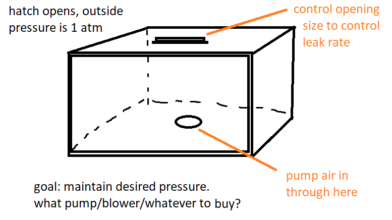

Here's a drawing of what I'm looking at:
When the machine is stopped, air will leak and equalize with the surrounding atmosphere (at normal temp / pressure). It can leak in any direction: the tubing is setup to take outside air in, and the hole on the top releases air back outside too, but it doesn't matter where the air leaks. What matters is maintaining constant pressure while the machine is on. So I have to buy a pump or blower or fan or whatever, then get the pressure up to the desired pressure (within some time t), then configure the pump so the leak rate is the same as the input rate such that the overall pressure is maintained.
I've gotten the rest of the software in place and integrated with the other logic, now this pump / opening part is the one I'm stuck on.
cashflow said:
Yes sir, I have to design a controller for variable pressure control, where the differential pressure is just a few kPa (abs pressure a few kPa over local air pressure).
Before designing a controller you need to know:
1) The maximum and minimum pressure over ambient. Fans and blowers, at least in the US, have the pressure specified in inches of water.
2) The maximum and minimum air flow rate.
3) Will the maximum pressure and maximum flow rate happen at the same time?
Then look for an air mover that will deliver the maximum pressure, the maximum flow, and the maximum combination of pressure and flow. There are several good manufacturers. I have had good experience with New York Blower, plus they have a good web site. Here is an excerpt showing their range of high capacity blowers:
Look for a blower that meets your needs, then read the power required. That will get you an approximate size, which you can use to decide if you really want to do this or if you should go back and design for lower pressure, lower flow, or both. Remember to calculate the duct loss from the blower to the box.
If you decide to proceed, call the company and have one of their sales engineers size and quote a blower and motor for you. You will then need a variable frequency drive (VFD) for the blower motor. And a pressure sensor. And a controller to connect the pressure sensor to the VFD.
The pressure you are talking about (20 in w.c. was mentioned) will result in a high noise blower. There will be noise from both the inlet and outlet of the blower. The manufacturer can tell you the noise levels, and possibly provide silencers if needed. There will also be noise from the high velocity air exiting the box. If any of those noise sources require silencer(s), you will need to add in the duct loss of those silencers to the total blower pressure needed.
