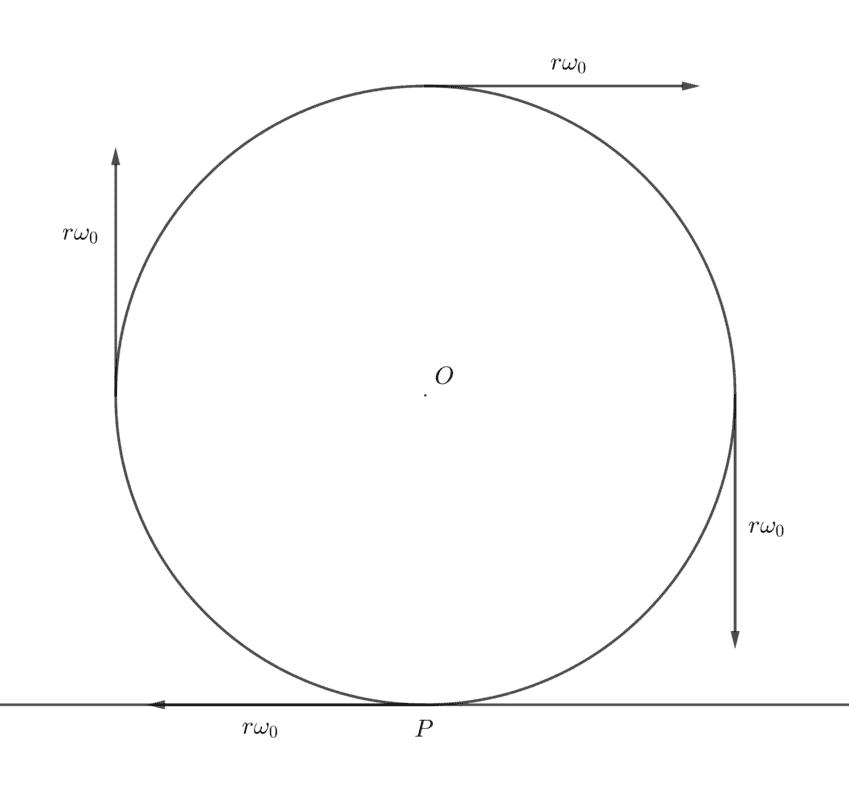

Suppose ##P## to be the point that first contacts the surface. Because this body was initially rotating, this point would want to move backward relative to the surface, with velocity ##r\omega_0##.
So kinetic friction will act, and the object will be accelerated forward. First, does kinetic friction act only on this contact point? Or else, does it act on all points, and accelerate all points on the object at the same rate?
If the latter is true (and I have assumed it is true in my model), then it must further increase the velocity ##r\omega_0## of the topmost point making it move rapidly forward, and increase the horizontal velocity components of the other points above the midpoint, causing them also to move forward, whereas the lower points will be made to move backward. How is this possible?
Clearly, all points must move backward, until the object gets into purely rolling motion.

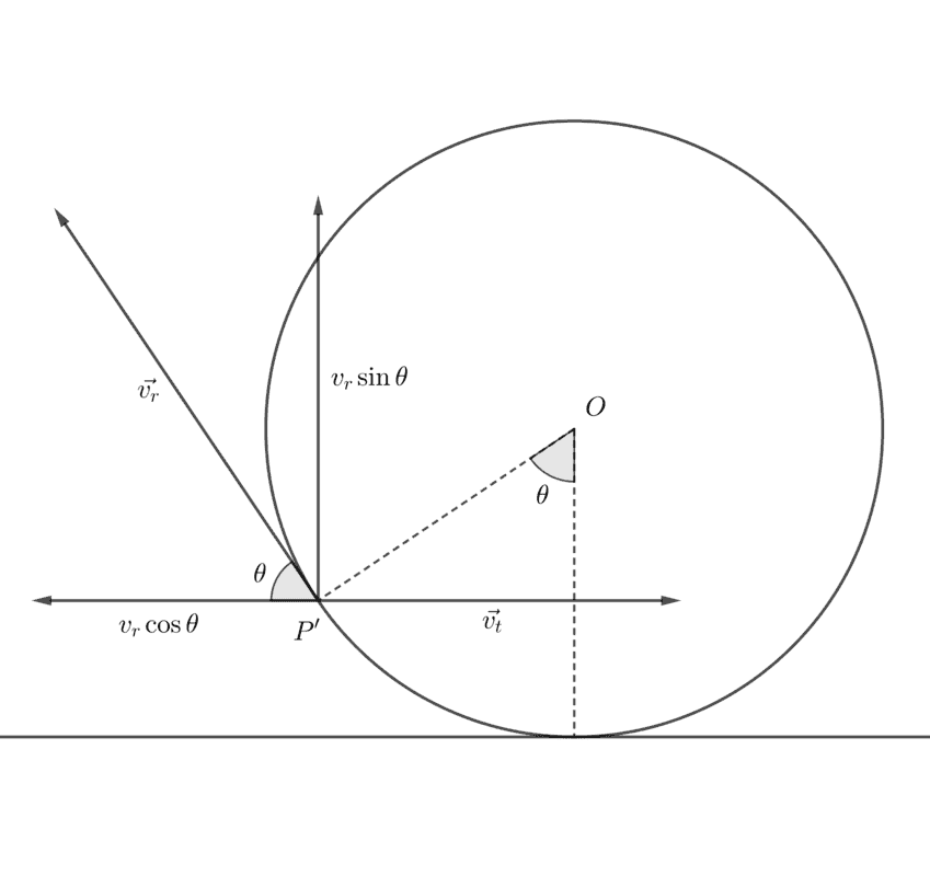

Consider a general position ##P'## of point ##P##. Suppose it would have turned through an angle ##\theta## with respect to the new contact point. Let the translational velocity acting on it be ##v_t##, and its tangential velocity due to rotation be ##v_r##.
I can come up with the following definitions for ##\theta##, ##v_r## and ##v_t## as functions of time ##t##, as follows. Do point out any errors in them, if there are any.

Therefore, supposing the coordinates of ##P## on an ##xy## plane are ##(0,0)##, I can obtain the ##x## and ##y## coordinates ##(x(T), y(T))## of ##P## at any time ##T## where
x(T)=\int_0^T v_t(t)-v_r(t)\cos\theta(t)dt,
and
y(T)=\int_0^T v_r(t)\sin\theta(t)dt.

Let the translational velocity acting on it be ##v_t##, and its tangential velocity due to rotation be ##v_r.##
As those are not orthogonal, you could easily confuse yourself viewing it that way.

Well, the equations I have obtained are relative to the ground, and they tell me that points above the midpoint move to the right relative to the ground, and points below the midpoint move to the left relative to the ground. That is not possible, is it?
If the wheel is not moving forward but spinning on a frictionless surface then that is what will be happening. Any point on the wheel from 3 o'clock to 9 o'clock will be moving backwards. If it grips slightly and starts to move forward, then some points on the rim near the contact point will still be moving backwards relative to the ground. This will get less and less as it accelerates and slips less.
In fact, it's only once the wheel is rolling without slipping that the contact point will be instantaneously stationary and points on the rim will trace out a cycloid relative to the ground.
For after it has achieved rolling, you have
v_r= r\left(\omega_0-\dfrac{\alpha r\omega_0}{a+r\alpha}\right) =r\left(\dfrac{a\omega_0}{a+r\alpha}\right) ##
v_t= \dfrac{a r\omega_0}{a+r\alpha}##
and the net forward velocity of point P' is
v_t-v_r\cos(\theta)=\dfrac{a r\omega_0}{a+r\alpha}(1-\cos(\theta))##
This is never negative.
Prior to achieving rolling, it will be negative for some range of theta.
