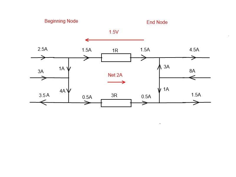

If we had a parallel circuit with a voltage of V between the beginning and end, and the circuit has a resistance R, then the current given by ohms law is I = V/R.
What does this mean? The current is not the same throughout the whole circuit. Where is the current equal to this value?
When you say that the "circuit has a resistance R", you must specify two points in the circuit that the resistance is measured between. (Often the two points are considered to be self explanitory and are not specified.) The current from one of those points to the other is the current of Ohm's law.

The current "I" is the total or net current flowing between the "beginning" and "end" nodes. However there does not need not be a place anywhere that a current of that value can be measured.
Consider the circuit below. It has two resistors in parallel (1R and 3R) between two nodes called "beginning" and "end". The equivalent resistance is 0.75R. The voltage between these two nodes is 1.5V so the total current according to Ohms law is I = V/R = 1.5/0.75 = 2A. The individual currents flowing in the two resistors are 1.5A and 0.5A also making 2A in total.
There is no single wire anywhere in the circuit where you can actually measure 2A.

A resistor is a two-terminal device. The current in one terminal is equal to the current out the other terminal. There is no splitting. Then I is the current entering the resistor and V is the voltage of the "in" side measured relative to the voltage at the "out" side, and V=IR.

Many of these replies to the OP are just overkill. Isn't this just the old chestnut about current being 'used up' on the way round a circuit? As far as I can see, it is and it needs to be answered at an appropriate level. The current is the same coming out of the circuit as going in. What is actually in the black box 'between the two terminals' is not relevant; current does not get used up.

In the simple parallel circuit of the OP, each individual parallel path has a current which agrees with the resistance and the voltage drop along that path. Furthermore, the total current at an end junction agrees with the equivalent resistance (R in the equation ##\frac{1}{R}=\frac{1}{R_1}+\frac{1}{R_2}##) and the voltage drop between the end junctions.
For more complicated networks, Kirchhoff's laws must be applied to understand the currents and voltages.
