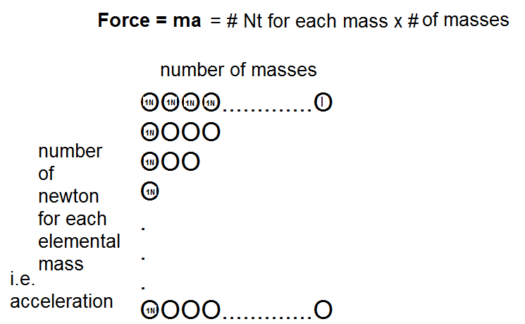

We also need to look at how we define certain quantities in science. Force is defined in terms of the accleration produced on a certain mass.
So the equation F=ma indicates that if you double the force you would get twice the accleration, mass remaining constant and experiment proves this to be correct.
